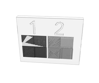

Form 1
The Form-1 only takes stl and obj files as input for printing. Because the final file for the resolution test in greener1's post was a png stack, the first step was to make an stl that would properly represent the png-stack. This was done by close inspection of the png's and the knowledge that the smallest pixel in the line-patterns were 50 microns (.05 mm) on a side. Using a lot of copy, scaling and rotating tricks, the geometry was replicated in Rhino3D using planar curves and extruding to solids. Note that angled lines in the image are unavoidably pixelated, with stepped boundaries. This feature was not copied in the stl. Instead the angled lines were made to be 50 microns wide and smooth (in the case of 1 pixel per line pattern) or 100 microns (in the case of the 2 pixels per line) and so on.
The final solid was booleaned together and exported to a massive poly-count stl. No wonder the original file was a png stack, it was likely much more efficient at storing the data than saving all those polygons!
