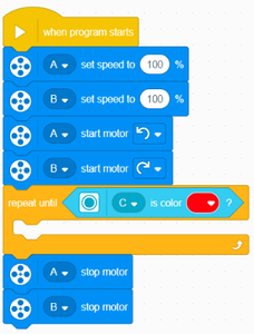

  1. Word Blocks (SPIKE App 3)Download here

✅ The robot moves straight and stops when the color sensor detects red
✅ Travel distance before detection: ~30 cm
✅ Speed: ~900 deg/s
✅ Measure the stopping distance (braking distance) from the moment red is detected until the robot stops completely
✅ Conduct five trials for each environment and calculate the average stopping distance
✅ The same logic was used for all environments

Step 5: Results: Which Environment Performed Best?
Here are the average stopping distances (shorter is better):
1️⃣ 24mm - C Language (spike-rt)🏆
2️⃣ 26.6mm - Python (Pybricks)
3️⃣ 27mm - Word Blocks (SPIKE App 3)
4️⃣ 27.2mm - Python (SPIKE App 3)
🔹 The C language environment (spike-rt) had the shortest stopping distance, meaning it responded the fastest.
