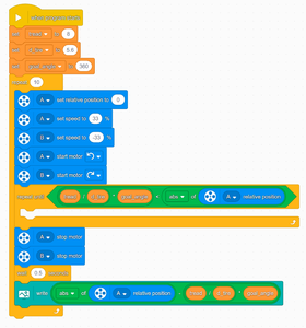

Step 4: Program Code
Python(SPIKE App3)
Python(Pybricks)
C Language (spike-rt)
