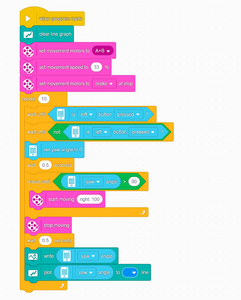

Step 1: Tested Programming Environments
I compared the following four environments:
  1. Word Blocks (SPIKE App 3)Download here
  2. Python (SPIKE App 3)Download here
  3. Python (Pybricks)More info
  4. C Language (spike-rt)GitHub repository

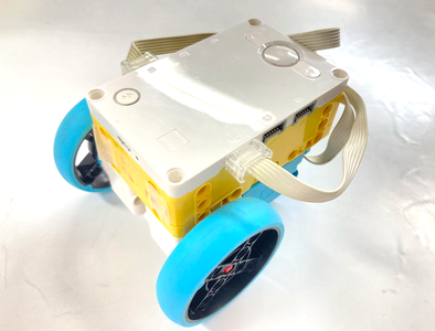

Step 2: Robot Configuration
For the test, I used a car-type robot with the following setup:
  1. Left motor: Port A
  2. Right motor: Port B
Step 3: Test Method
To compare the environments, I conducted the following test:
  1. Use the hub’s gyro sensor to rotate the robot 90°
  2. Measure the difference between the target angle (90°) and the actual rotation
  3. Perform 10 trials for each environment and calculate the average error
