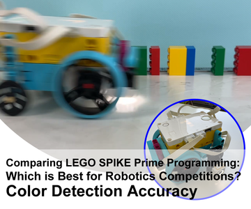

Introduction: Comparing LEGO SPIKE Prime Programming: Which Is Best for Robotics Competitions? - 4 : Color Detection Accuracy
When participating in a robotics contest using LEGO SPIKE Prime, choosing the right programming environment can impact performance. In this experiment, we tested how accurately different programming environments detect colors while the robot is in motion.

Step 2: Robot Configuration
For the test, I used a car-type robot with the following setup:
  1. Left wheel motor: Port A
  2. Right wheel motor: Port B
  3. Side-facing color sensor: Port C
  4. Downward-facing color sensor: Port D
Step 3: Test Method
To compare the environments, I conducted the following test:
  1. The side-facing color sensor detects various block colors while the robot moves.
  2. The downward-facing color sensor detects black and stops the robot.
  3. Each environment was tested five times, and the average results were compared.
  4. Programs were optimized for each environment while keeping the movement speed nearly the same.

Expected color detection sequence:
None → Red → None → Green → None → Green → Red → None → Yellow → Blue → None → Green → None → Red → None → Blue → None
Step 6: Results: Which Environment Was Most Accurate?
The environment with the least misdetections was C Language (spike-rt):
  1. 2% - C Language (spike-rt)
  2. 5% - Python (Pybricks)
  3. 22% - Word Block (SPIKE App3)
  4. 27% - Python (SPIKE App3)
Observed Trends
Word Block & Python (SPIKE App3):
  1. More likely to misdetect colors when changing to/from green (often detecting light blue or black by mistake).
  2. More likely to misdetect white when changing from yellow.
  3. More likely to misdetect light blue when changing from blue.
  4. Seemed to detect background colors instead of "None" when the object’s color was ambiguous or distant.
Pybricks & C (spike-rt):
  1. More likely to misdetect yellow when changing from green.
