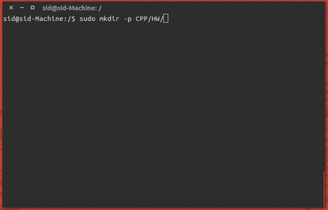

Step 2: Create a Seperate Folder to Hold Your Programs
Use the below command to make a directory on your desktop.
sudo mkdir -p CPP/HW/
By using the above command we are making a folder named 'CPP' & a sub-folder named 'HW' inside it.

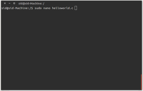

Step 4: Creating the Program File With 'nano'
We will use 'nano' an inbuilt simple text editor to create & write programs & their files. Use the command below to make your program file.
sudo nano helloworld.c

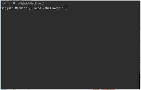

Step 7: Executing Your Program
Type the below command to execute your program.
sudo ./helloworld
we typed ./helloworld since our compile version in the previous step is helloworld. If its xyz then we will type ./xyz
After typing this your program output will be shown in the Terminal.
