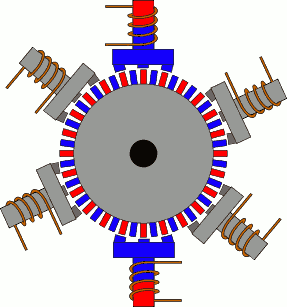

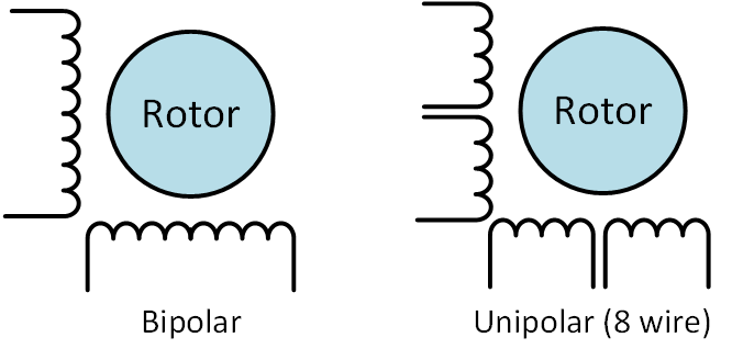

- Stepper Motor Controllers: used with unipolar or bipolar stepper motors depending on their kind.

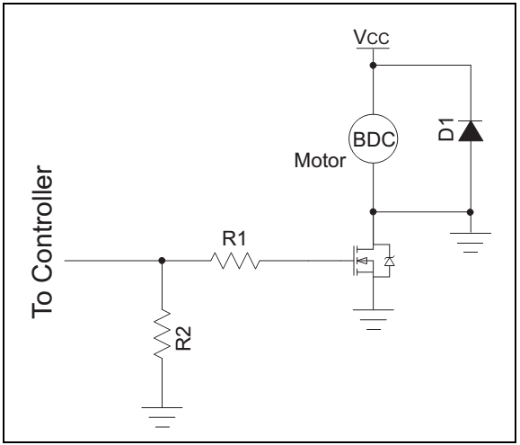

Practically, Drive circuits are used in applications where a controller of some kind is being used and speed control is required. The purpose of a drive circuit is to give the controller a way to vary the current in the windings of the BDC motor. The drive circuits discussed in this section allow the controller to pulse width modulate the voltage supplied to a BDC motor. It is more efficient way to vary the speed of a BDC motor compared to traditional analog control methods. In some cases the motor only needs to spin in one direction then a single switch topology with PWM modulation can be used to vary the voltage applied to the motor and thus to control its speed. The higher the PWM duty cycle, the faster the motor will go. Figure shows circuit for driving a BDC motor in one direction using single FET (field effect transistor).
Note that in the circuit there is a diode across the motor. This diode is there to prevent Back Electromag- netic Flux (BEMF) voltage from harming the MOSFET. BEMF is generated when the motor is spinning. When the MOSFET is turned off, the winding in the motor is still charged at this point and will produce reverse current flow. D1 must be rated appropriately so that it will dissipate this current.
Resistors R1 and R2 in the Figure are important to the operation of the circuit. R1 protects the microcontroller from current spikes while R2 ensures that transistor is turned off when the input pin is tristated.
When positioning is required or when both directions of rotation are needed (most robots need) a full H-bridge with PWM control is used. The H-Bridge is a 4-transistor circuit that allows you to reverse the current flow to the motor. With an H-Bridge and a PWM pin, you can control both the speed and direction of the motor.

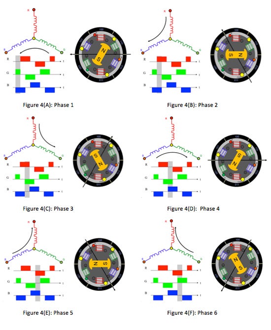

The mechanics of a brushless motor are incredibly simple. The only moving part is the the rotor, which contains the magnets. Where things become complicated is orchestrating the sequence of energizing windings. The polarity of each winding is controlled by the direction of current flow. The animation demonstrates a simple pattern that controllers would follow. Alternating current changes the polarity, giving each winding a “push/pull” effect. The trick is keeping this pattern in sync with the speed of the rotor. There are two (widely used) ways this can be accomplished. Most hobby controllers measure the voltage produced (back EMI) on the un-energized winding. This method is very reliable in high velocity operation. As the motor rotates slower, the voltage produced becomes more difficult to measure and more errors are induced. Newer hobby controllers and many industrial controllers utilize Hall effect sensors to measure the magnets position directly. This is the primary method for controlling computer fans.
Control
The control of the brushless DC motors is very different from the normal brushed DC motor, in that it this type of motor incorporates some means to detect the rotors angular position (or magnetic poles) required to produce the feedback signals required to control the semiconductor switching devices. The most common position/pole sensor is the “Hall Effect Sensor”, but some motors also use optical sensors. Using Hall effect sensors, the polarity of the electromagnets is switched by the motor control drive circuitry. Then the motor can be easily synchronized to a digital clock signal, providing precise speed control. Brushless DC motors can be constructed to have, an external permanent magnet rotor and an internal electromagnet stator or an internal permanent magnet rotor and an external electromagnet stator.
In figure 4 (A), the GREEN winding labeled “001” is energized as the NORTH pole and the BLUE winding labeled as “010” is energized as the SOUTH pole. Because of this excitation, the SOUTH pole of the rotor aligns with the GREEN winding and the NORTH pole aligns with the RED winding labeled “100”. In order to move the rotor, the “RED” and “BLUE” windings are energized in the direction shown in figure 4(B). This causes the RED winding to become the NORTH pole and the BLUE winding to become the SOUTH pole. This shifting of the magnetic field in the stator produces torque because of the development of repulsion (Red winding – NORTH-NORTH alignment) and attraction forces (BLUE winding – NORTH-SOUTH alignment), which moves the rotor in the clockwise direction.
Speed Control
Brushless dc motor are actually three phase ac motors. To controll the speed an electronic speed control or ESC is used. Brushless ESC systems basically create a tri-phase AC power output of limited voltage from an onboard DC power input, to run brushless motors by sending a sequence of AC signals generated from the ESC's circuitry, employing a very low impedance for rotation. Brushless motors, otherwise called outrunners or inrunners depending on their physical configuration, have become very popular with "electroflight" radio-control aeromodeling hobbyists because of their efficiency, power, longevity and light weight in comparison to traditional brushed motors. However, brushless AC motor controllers are much more complicated than brushed motor controllers.
The correct phase varies with the motor rotation, which is to be taken into account by the ESC: Usually, back EMF from the motor is used to detect this rotation, but variations exist that use magnetic (Hall Effect) or optical detectors. Computer-programmable speed controls generally have user-specified options which allow setting low voltage cut-off limits, timing, acceleration, braking and direction of rotation. Reversing the motor's direction may also be accomplished by switching any two of the three leads from the ESC to the motor.

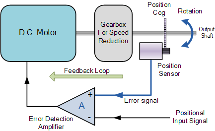

- Output sensor
- Feedback system
It is a closed loop system where it uses positive feedback system to control motion and final position of the shaft. Here the device is controlled by a feedback signal generated by comparing output signal and reference input signal.
Here reference input signal is compared to reference output signal and the third signal is produces by feedback system. And this third signal acts as input signal to control device. This signal is present as long as feedback signal is generated or there is difference between reference input signal and reference output signal. So the main task of servomechanism is to maintain output of a system at desired value at presence of noises.
Working principle of Servo Motors
A servo consists of a Motor (DC or AC), a potentiometer, gear assembly and a controlling circuit. First of all we use gear assembly to reduce RPM and to increase torque of motor. Say at initial position of servo motor shaft, the position of the potentiometer knob is such that there is no electrical signal generated at the output port of the potentiometer. Now an electrical signal is given to another input terminal of the error detector amplifier. Now difference between these two signals, one comes from potentiometer and another comes from other source, will be processed in feedback mechanism and output will be provided in term of error signal. This error signal acts as the input for motor and motor starts rotating. Now motor shaft is connected with potentiometer and as motor rotates so the potentiometer and it will generate a signal. So as the potentiometer’s angular position changes, its output feedback signal changes. After sometime the position of potentiometer reaches at a position that the output of potentiometer is same as external signal provided. At this condition, there will be no output signal from the amplifier to the motor input as there is no difference between external applied signal and the signal generated at potentiometer, and in this situation motor stops rotating.

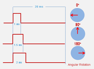

Servo motor is controlled by PWM (Pulse with Modulation) which is provided by the control wires. There is a minimum pulse, a maximum pulse and a repetition rate. Servo motor can turn 90 degree from either direction form its neutral position. The servo motor expects to see a pulse every 20 milliseconds (ms) and the length of the pulse will determine how far the motor turns. For example, a 1.5ms pulse will make the motor turn to the 90° position, such as if pulse is shorter than 1.5ms shaft moves to 0° and if it is longer than 1.5ms than it will turn the servo to 180°. Servo motor works on PWM (Pulse width modulation) principle, means its angle of rotation is controlled by the duration of applied pulse to its Control PIN. Basically servo motor is made up of DC motor which is controlled by a variable resistor (potentiometer) and some gears. High speed force of DC motor is converted into torque by Gears. We know that WORK= FORCE X DISTANCE, in DC motor Force is less and distance (speed) is high and in Servo, force is High and distance is less. Potentiometer is connected to the output shaft of the Servo, to calculate the angle and stop the DC motor on required angle.
To recap, there are two important differences between the control pulse of the servo motor versus the DC motor. First, on the servo motor, duty cycle (on-time vs. off-time) has no meaning whatsoever—all that matters is the absolute duration of the positive-going pulse, which corresponds to a commanded output position of the servo shaft. Second, the servo has its own power electronics, so very little power flows over the control signal. All power is draw from its power lead, which must be simply hooked up to a high-current source of 5 volts.

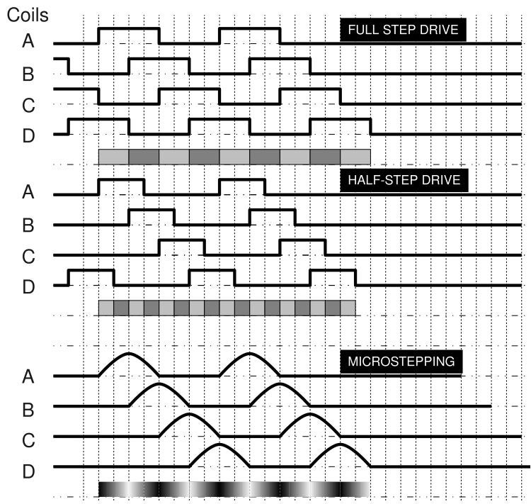

Driving a Stepper
Driving a stepper motor is a bit more complicated than driving a regular brushed DC motor. Stepper motors require a stepper controller to energize the phases in a timely sequence to make the motor turn.
There are several different ways that stepper motors are able to be driven including full step, half step, and microstepping. Each of these driving styles offer different amounts of torque and step sizes that the stepper motor can use.
A full step drive always has two of the electromagnets "turned on". To rotate the central shaft, one of the electromagnets gets turned off and the next electromagnet is turned on, causing the shaft to rotate 1/4 of a tooth (at least for hybrid stepper motors). This style of always having two electromagnets on has the most torque out of all of the styles, but the largest step size. A half step drive alternates between having two electromagnets and just one electromagnet turned on. To rotate the central shaft, the first electromagnet is energized as the first step, then the second one is also energized while the first one is still powered for the second step. The third step turns off first electromagnet and the fourth step turns on the third electromagnet, all while the second electromagnet is still powered. This pattern, shown in a picture above, uses twice as many steps as the full step drive, allowing for half of the step size, but it also has less overall torque since there are not always two electromagnets holding the central shaft in place. Microstepping, not surprisingly, has the smallest possible step size out of these styles. One of the most common ways to peform microstepping is to do "sine cosine microstepping". This means that the current flowing through each coil is manipulated such that a sine/cosine wave is created. The "overlap" of the waves between two coils results in a large number of substeps. The actual number of substeps is dependent on how many distinct changes in current you can provide to the coils, but microstepping will still have the smallest step sizes, and thus the most precise movement, out of all of the styles. The torque associated with this style is dependent on how much current is flowing through the coils at a particular time, but will always be less than the full step drive.
The simplest type of driver can be built with a handful of transistors. These are simply switched on and off in sequence to energize the phases and step the motor. Unipolar drivers are relatively inexpensive to build, but only work with unipolar motors. There is an excellent tutorial on how to build one at the Arduino site.
Driving a bipolar motor requires 2 full H-bridges so it can reverse the current to the phases. H-bridges can be tricky to build from scratch. But there are plenty of H-bridge chips available to simplify the task.The L293D is one of the most popular and economical chips. These can be found at the heart of most first-generation motor shields.
Following code snippet can be used to control stepper motor using arduino board.
