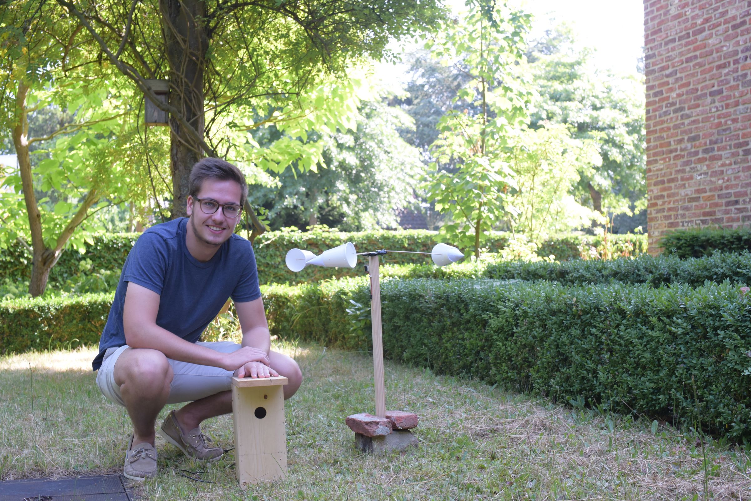

Step 13: Put Everything in the Enclosure
Take your housing and position the electronics so there are evenly spaced out. I will use my newly made birdhouse, I included the design down below. It is a simple box with a false bottom to store the Raspberry Pi.
Note: there always has to be a stream of airflow for the humidity sensor to work properly. Once you are satisfied with the result you can close everything and the weather station is finished. You can now place it somewhere you like and collect the weather data.
Step 14: Your Weather Station Is Working
Congratulations your Raspberry Pi is now fully functional. Place it somewhere in the open and collect the data!
