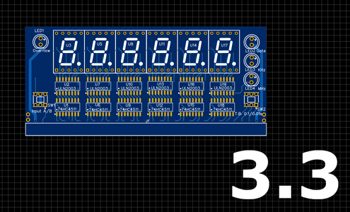

Photo 3.2 shows the PCBs (P1 and P2) for ACVar. Photo 3.3 and 3.4 are 2D images for the same PCBs.
Photo 3.5 shows the PCB for the CCVar, and Photo 3.6 is a 2D image for it.

Assembling the PCBs can be done using the data from the links from Step2 or the 2D images from Step3.
