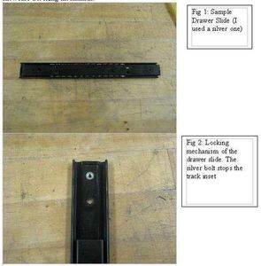

Start off with a simple drawer slide , the drawer slide must allow you to remove the track from the slide. The innate locking mechanism of the track may also be useful to showcase a locking mechanism (Fig 1). You will also want to pick up hinges of all different sizes. I used 4 different hinges, 3 of which were rather large ACE brand long hinges, and one small miniature hinge. You will also need screws, washers, bolts, bushings, and spare aluminum parts. The size of which is up to you, as you will be drilling the holes at a size of your individual discretion. I will make suggestions on size at times, but it is up to you. These are the essential materials. Other materials are also needed later for retrofitting onto the wheelchair and for ergonomic considerations.

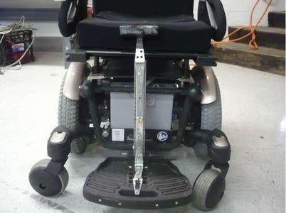

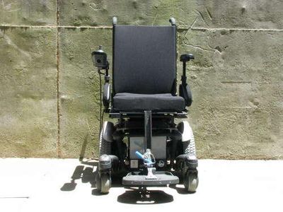

The final outcome (1st image ) is shown in this step to give you an idea of what you are eventually going to end up with, and also help elucidate some of the reasoning and steps along the way.

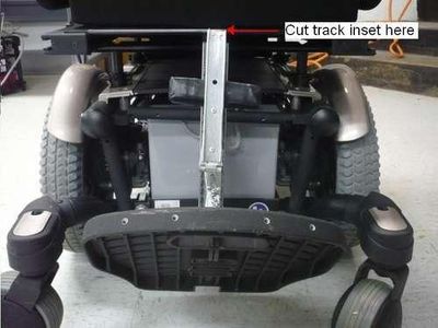

The first real step of construction is now upon us. First, the track slide may need to be cut down to size (less than 14 inches between base of footrest and seat bottom) in order to fit most power wheel chairs (Refer to final outcome pic, 1st image for better idea of where the device rests). Do this with a hacksaw.

Terminology (Fig 3, 2nd Image)
track slide will refer to the drawer slide
track base will refer to the non-mobile base portion of the drawer slide
track inset will refer to the mobile inset portion of the drawer slide
After cutting the track base and inset, you may have to recreate the original locking mechanism. Fig 4, 3rd Image . showcases what I did compared to the original locking mechanism. What I did was drill two holes as the stopper for the ball bearings slide, and drill a hole and use a bolt as the new catch. This only works because the excess metal from the drill hole protrudes and acts like the original stopper bolts/protrusions.

The track inset will need to be cut again . This time, the cut is made, so that when the track inset travels up the track base and reaches the catch-lock (shown in Fig 4, 3rd Image of Step 2), it does not extend past the seat well (bottom underside of seat). Place the track slide, vertically, near the base of the footrest, and extend the track inset up, from the track base until it locks into the base's locking mechanism (mentioned in step 2). The track inset may travel above the plane of the seat well, and would interfere with transfer. Measure the point at which the track inset travels above the plane of the seat well, you will want to cut at this point (See 1st Image ).

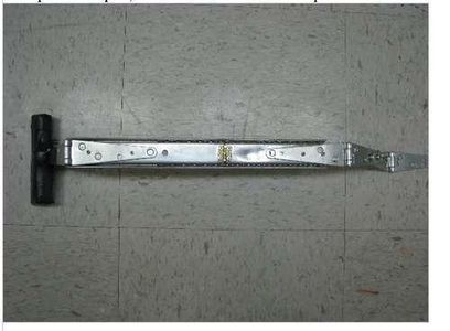

Step 4: Creating the Handle

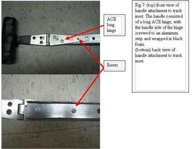

The handle will be attached to the longer piece of the hinged two-part track inset from step 3. You may want to consider using a long hinge, such as shown in Fig 7, Image.
You attach one portion of the hinge to the track inset via rivets (two drilled holes of appropriate sizes), or screws. Once again, my rivets were .125 in, with .133 drill bits.
The other side of the hinge can now be fitted with whatever handle design you would like . I bolted on a piece of spare aluminum and covered it in foam tape for a T-handle.

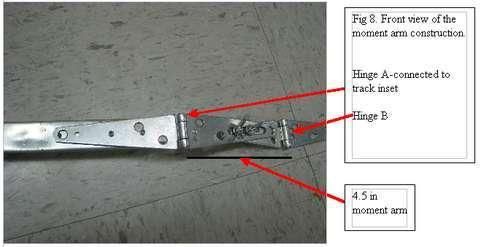

Now we must create the actual attachment from the track to the footrest. This will require two relatively long hinges.
I have labeled them as A and B in figure 8, 1st Image
First, find a long hinge(A) that is at least as long as your chosen moment arm length. Based on the length of the moment arm (of your choosing), you may need to cut one side of the hinge down. (If you don't want to deal with the physics for moment arm calculations, just find a hinge around a 4.5 inch length. ) For my mock-up, I left it at 4.5 inches (Fig 8, 1st Image) .
Next, you will need to create the slotting mechanism. This mechanism increases your moment arm length, during lift, as well, so this must be taken into account for optimization.
Find a set of small bushings . These will be used as your rollers in your slot. Take your hinge, and use the mill to create a slot of width dependent on the diameter of your bushings (use calipers). See Fig 9, 2nd Image . You must make many passes with the mill and use lubrication, because the hinge material is steel.
Third, take your second hinge (B), and you must attach the bushing rollers to this hinge.
The bushings must either be cut or filed down to the height of the thickness of the hinge A . Please see Fig 9, 2nd Image for reference . Find two bolts which fit within the inner holes of the two bushings. Drill holes corresponding to bolt size through the hinge (B). The distance between these two holes also dictates how much extension your moment arm will have. You may want to consider drilling more holes for testing purposes.
Now fit both bolts through the holes in hinge B, then the bushings, and finally through the slot of hinge A (Fig 9, 2nd Image) . Make sure that the bushings move and roll easily within the slot and creates an extension motion.
Lock in the bushings now with washers and wing nuts/nuts/locknuts .

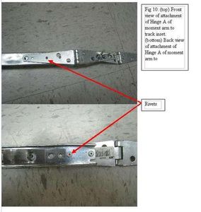

Attach hinge A from the moment arm, step 5, to the track slide with rivets.
Drill two holes in both the track inset and hinge A and use rivets to secure. Once again, you may have to file down the rivets. The hinge may be attached below the bottom of the track slide, see Fig 10, Image. This is done because most footrests actually have a dip, and this allows to moment arm to sit flat on the footrest.

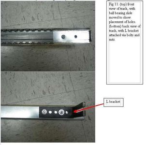

On the back of the track slide, you can drill two or three holes directly in the center, and put bolts through. This will allow you to connect L connectors or other retrofit apparatus, see Fig 11, 1st Image .
Using the L bracket, you can now attach to PWC via the footrest height adjustment.
