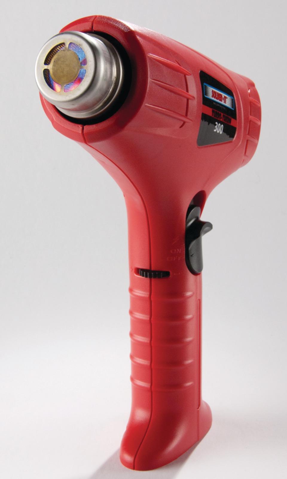

  • Heat Gun

Once the top and bottom had been cut off, you end up with a cylinder. My bottle is quite big, so I sliced this into 2 pieces. If your bottle is small you might not have to cut it into two. You can use the heat gun to shrink it a little bit by inserting the toilet roll inside the tube. Be careful as the plastic will melt and it is quite hot so wear gloves that can protect your hand and fingers.

WARNING: The plastic will melt before it will join together, so exercise caution and make sure you wear some gloves.
Once you have two tube, join them together using heat gun, again exercise care.

Then attach the hat to the top tube using the hot air gun.
WARNING: again, this process will melt the plastic bottle, so exercise caution to make sure you didn't get burned and wear some gloves. Gloves will protect your hand and also allow you to shape and move the joint so that it stick the way you want it.
