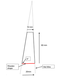

- Cut the wings using the hot wire method:
- Make the shape of your widest point of the wing (at the center) in wood and attach it to the side of the foam
- Span one side of the hot wire in one point, the other one you can move freely.
- Connect a power supply and follow with the end of the wire the wooden shape.
- When its done, you'll have a wing that's narrower at the end.
- Do the same for the other wing
- The middle part of the wing, you can use a normal hot wire cutter because its just a straight extrusion of the wooden shape (width 130 mm) .
