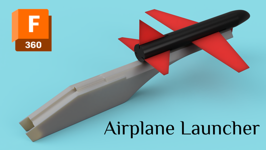

Step 1: Design the Launcher
First, I took a picture of the trigger I would be using and added it to my Fusion 360 design as a canvas. Then I scaled it and began tracing the profile of the attachment. After extruding it, I swept a circle along the tube's path to cut out just enough room for the trigger's nozzle. Then I made a new sketch for the acceleration chamber and extruded it, joining it to the attachment.
Compressed Air Airplane Launcher
Step 2: Design the Plane
The first step is to design the chamber insert, which will transfer the air's kinetic (originally potential) energy to the plane.
It took me two design attempts to get a plane that worked decently well. In my first design, I was inspired by the F-117. However, this design was very unstable in the air, and would just do about 10 flips after being launched rather than flying and covering ground. Although it looked sort of cool as well, I wanted something that flew a bit better, at least for the first portion of the flight.
I decided to redesign it more like a commercial jet–with less area under the wings and an actual fuselage. First, I made a cylinder and lofted the end to a point. Then, I cut slots for the wings. Next, I made the wings to fit in the slots. Finally, I cut a hole in the bottom of the plane for the chamber insert. This insert is what accelerates it out of the chamber.
This iteration worked much better, as you can see in the video in the following section.
