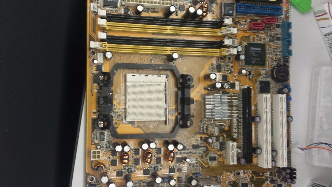

Step 2: Motherboard
First you need to get your motherboard. Establish where the processor goes, and proceed from there.
Step 3: Processor
First you put your processor in. You have to lift the lever first, and then line up the triangle on the motherboard with the one on the processor. There should be zero insertion force, so don't push.

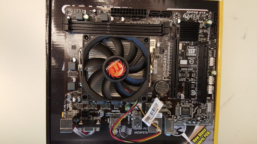

Step 4: Heat Sink
Next you take your heat sink and put it on top of your processor. Apply a little thermal paste if needed, but most heat sinks already have some. Stick it on top and latch it in place with the latches on the side. Plug in the fan power cable into the pins labeled CPU fan

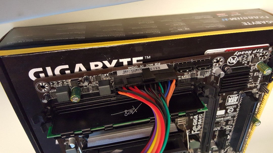

Step 7: Power Supply
Next take out your power supply. Hook in the 24 pin into the motherboard. Then hook your power cord into the power supply.

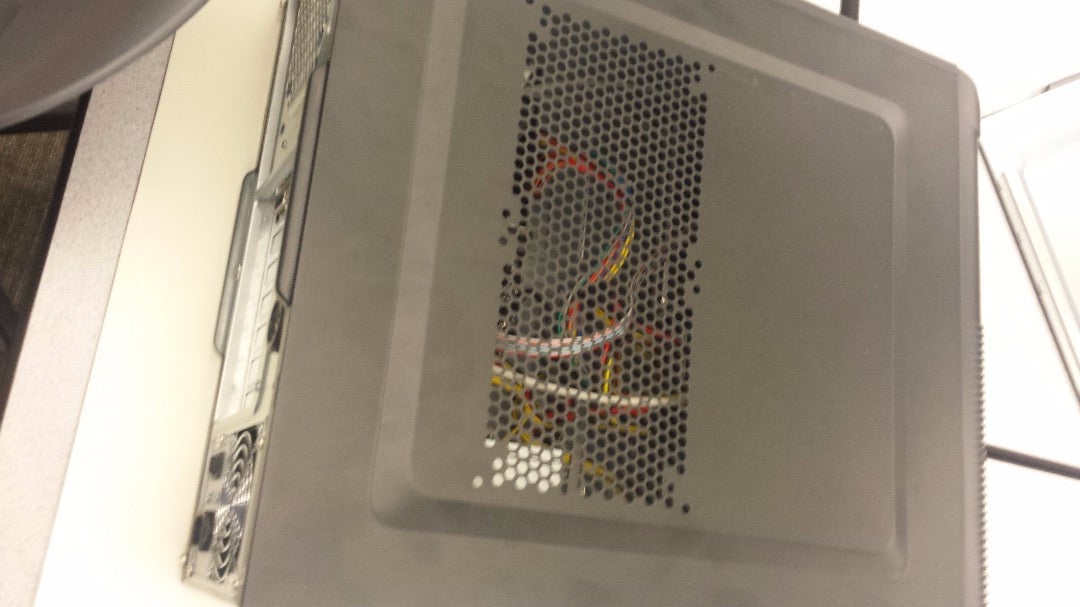

Step 12: Final Steps
Put your case back on. You should have a new working computer! Plug in your power supply and monitor. You can now download windows and enjoy!
