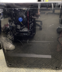

Step 2: Case
The case is what will house all of the components

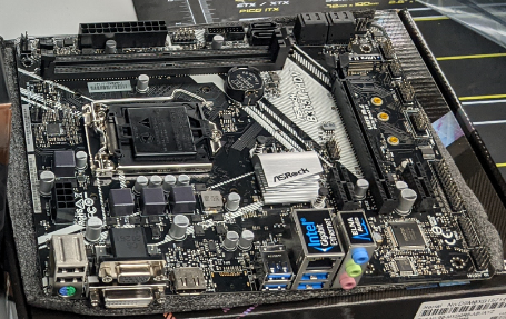

Step 4: CPU/Heatsink
One you install the CPU into its socket (There will be a gold triangle on the CPU and a triangle on the socket so you know how to align it properly) then you can apply the heatsink. If there is no pre applied thermal paste on the heatsink make sure you apply a pea sized amount onto the CPU.

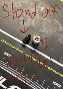

Step 5: Motherboard and Standoffs
When putting the motherboard into the case make sure you have standoffs applied first. There is a little tool to put on the standoff which allows you to screw the standoffs into the case

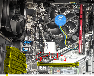

Step 7: Graphics Card
You will apply the graphics card into the highlighted area labeled GPU right above it. On the highlighted area on the left, you will have to remove the appropriate one to put the graphics card in.

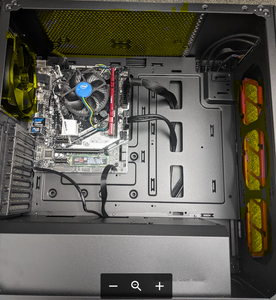

Step 8: Cable Management
Rout the cables through the closest hole in the case so that it looks better and you don't have cables everywhere.

Step 11: Case Fans
You can apply fans into any of the highlighted spots. The main places to put fans are the front and back, you do not need top fans it would just cool it a little more. The front fans should be bringing in air, and the back fan should be releasing the air. And if you are installing top fans make sure that they are blowing air out.
