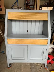

*During this step i made an error in measurement and made the doors too narrow. To compensate for this I added 4mm Playwood strips to the inside of the opening which helped fill the gap. As well as adding them on the lower section where the doors were located I also added it to the alcove where the speakers were mounted. It can be seen in the images as the darker strips. When this is painted it will not be seen. It was a quick solution which meant i didnt have to rebuild the doors!
Step 9: Paint and Hardware
All parts were disassembled and set out for painting. I decided to use Sadolin Superdec Cull Grey Fence Paint. The paint I used is highly durable, water based and guaranteed for 10 years - ideal for keeping furniture fresh when it needs to withstand the abuse of 2 young children. Three layers were applied and then finished with a matt laquer to finish.
Half moon handles with matching knobs were used for the drawer front and cupboard doors. A D-handle from the same hardware family will be added later to lift and lower the sliding panel.
Step 10: Finished Bureau

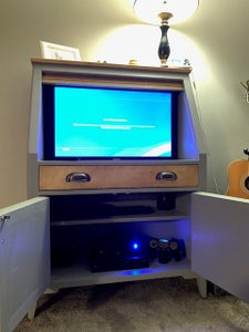

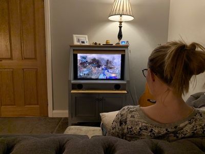

When the bureau was finished it was moved into position, in place of the large table that occupied the space previously. The PC and PS4 were attached to the 28" screen using HDMI cables. The audio was taken from the output on the screen and into a Monocor Amp which powers the 2x 6ohm speakers.
After the cabinet was used for some time I realised there was quite a bit of heat build up when the doors were closed so to help with this, I added a silent computer fan at the back of the bureau to remove the warm air created by the computer and the amp. This is powered via USB on the PS4 which comes on when the PS4 is in use, helping to keep the cabinet cool.
