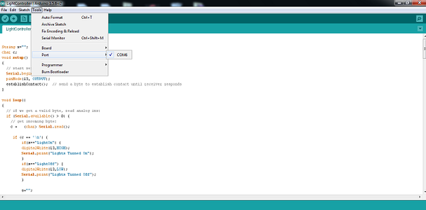

Step 11: Select the Correct Commmunication Port
Make sure the correct com port (the port assigned to Arduino) is selected. Open serial monitor provided with Arduino IDE.
Step 12: Send Command
Send “LightOn”. This will turn light on. Send “LightOff” to turn light off.
