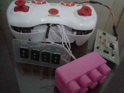

Step 2: Make the Changes
After the essential testing step, we will start applying changes to the transmitter. First, we have to cut the connection between the potentiometer outputs and the microcontroller. This is important, because in PC mode we need only the analog commands sent from the PC to be detected by the microcontroller. So using a razor blade, cut the connection between the potentiometers middle pin and the microcontroller. Next, open a small window behind the cut in the green painting that covers the connection between the potentiometer pin and the microcontroller. If we connect the window with the potentiometer pin, the microcontroller receives commands from the joysticks. If this connection is removed and an analog voltage is connected to the small window, the transmitter accepts this voltage as command. The manual/PC switch should be connected between the small window and the potentiometer pin.
Solder wires to the potentiometers' middle pins. By sending analog voltage through these wires, the quadrotor can be controlled via PC and/or Arduino. Note that in the figures above, I soldered the wires before performing the cut and the window using the razor blade.
Perform these changes to all the potentiometers. Connect also a power wire to the baterries' well. This allows you to connect an external adapter to get rid of the batteries when the drone is controlled by the computer

Step 5: Add the Switches
I waited a long time before ending this project because I couldn't find suitable switches. I still unable to find good switches, so I tried to end-up with a nice remote control using available switches and my kids' plastic playing bricks... sorry kids.
