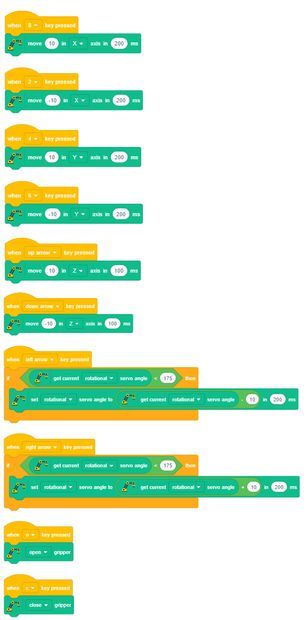

Step 9: Writing the Code
Before writing the code, we need to calibrate the Robotic Arm. Find the entire process of calibration over here.
Open PictoBlox and create the following script:
Create the script to initialize the robotic arm when the flag is clicked.
Following are the controls for the robotic arm.
