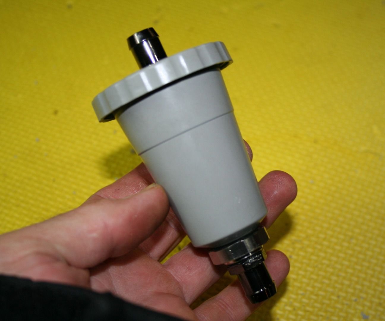

clean and leak test the reservoir and add the fittings of your choice
if your bottle has a wide enough mouth you can add a filter to the outlet.
