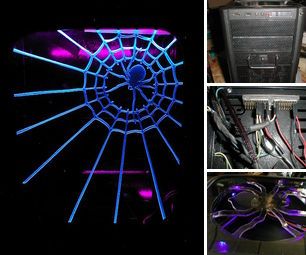

The first picture shows the lights off, the second is the blue lights and the third is with the UV's on.
