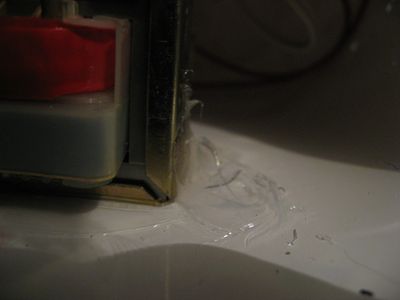

When everything is connected, plug it in and make sure it works. If it works, screw/fix any remaining parts into the box and start to add some finishing touches. If your speakers have the transformer like mine does you might have to make up some sort of frame for it on the bottom of the container to stop it moving. I just used to Silastic to glue it to the side.
