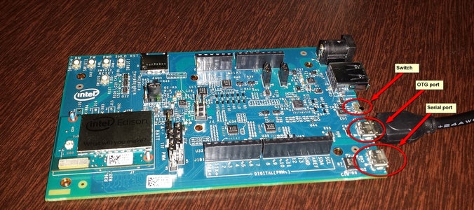

Step 2: Connect Edison to Your PC
Make sure the micro-switch on your Intel Edison Arduino board is set pointing to the two micro-USB ports
Connect Edison to your PC using the OTG port (Check images above). Windows shall recognize it as an external drive.
Then connect a second USB cable between your PC and the serial port on Edison

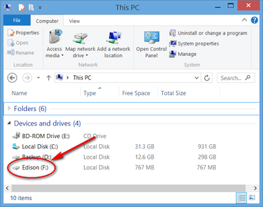

Step 4: Install the Firmware Image
Your computer shall recognize Edison as an external drive.
Open it and delete all files you found there.
Then uncompress all files inside the download zip image into the Edison drive

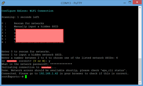

Step 5: Configuring Edison
Once you got the firmware updated, use the following commands to configure Edison:
"configure_edison --name": To give a name to your Edison board
"configure_edison --password": To set a password
And, the most important one:
"configure_edison --wifi" to connect Edison to your WiFi network, so you can go on with this tutorial

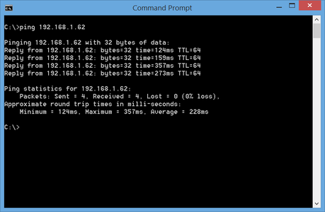

Step 6: Check Your Connection
Use PING, on your computer, to test if Edison is really 'visible' on your network
From now on, you can disconnect the serial cable and use SSH (Also on Putty) to control your Edison board. Or you can stick with serial terminal. It's up to you.

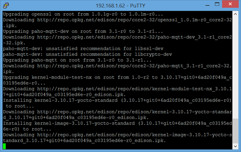

Step 7: Adding OpenCV Packages to Edison
We're gonna use opkg to install all packages we need on Edison
Type these three command lines to add new repositories to opkg list:
echo "src/gz all http://repo.opkg.net /edison/repo/all" >> /etc/opkg/base-feeds.conf
echo "src/gz edison http://repo.opkg.net/edison/repo/edison" >> /etc/opkg/base-feeds.conf echo "src/gz core2-32 http://repo.opkg.net/edison/repo/edison" >> /etc/opkg/base-feeds.conf
Then type "opkg update" to update the repositories list
And type "opkg upgrade" to update the installed packages. It takes some time until it finishes this process.
Finally, install the packages we need for openCV:
opkg install python-numpy opencv python-opencv

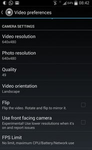

Open the app, click on "Configure video" and set video resolution to 640x480. Since Edison processing power is limited, we can't work with full camera resolution images on OpenCV. Also, smaller images will be transmitted faster via WiFi, improving the FPS on Edison.

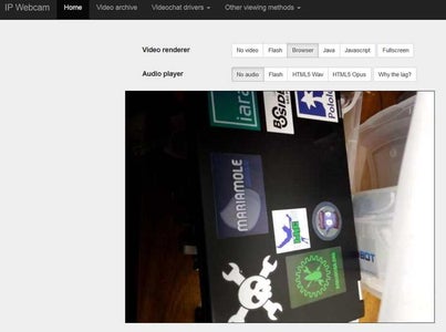

Step 9: Testing IP WebCam
After configuring IP WebCam, click on "Start server". Check that your phone goes into "camera mode", and its IP address is shown at the bottom of the screen, as a URL
Type this URL in your computer browser and you shall be able to see the video streaming from the phone

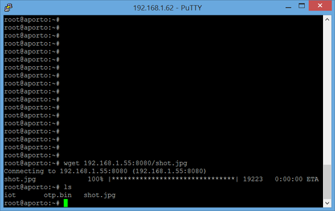

Step 10: Capturing the Phone Video From Edison
Instead of using video on Edison, we'll work with sequences of images. This makes no difference on the final result, but makes a lot easier to grab the phone output
On Edison terminal (SSH or Serial), use wget to download the current camera image as a jpeg file:
"wget :8080/shot.jpg"
Now you have a jpg file that you can use on OpenCV
