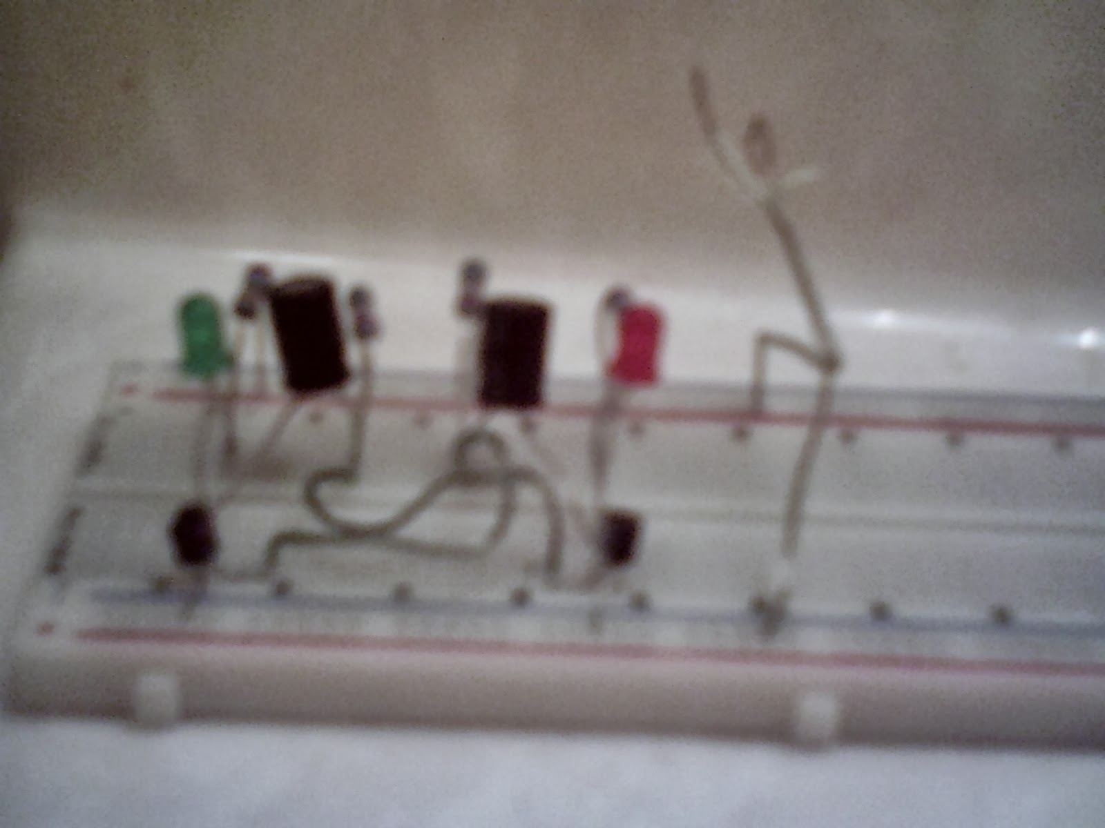

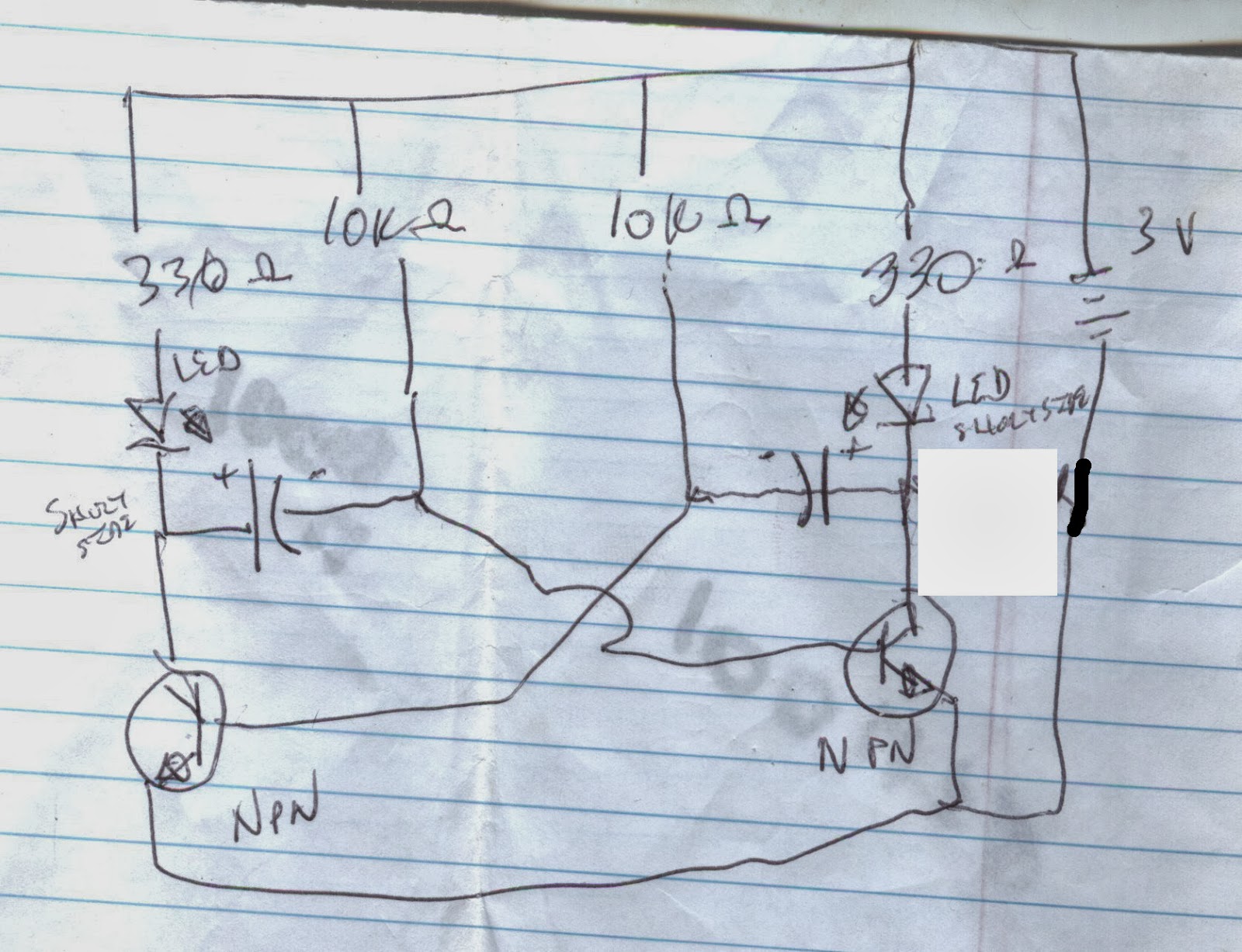

Step 10: Standalone Blinking Light Circuits.
These are great for building artitificial candles and the like.
Blinking led attached to coin battery.
Negative resistance blinker
Multivibrator circuit..
Schematic:
Parts used:
2 - leds (different colors adds more mystique)
2 - 330 ohm resistors
2 - 10k ohm resistors
2 - 2n2222 transistors (npn)
2 - 100uf 50v Electrolytic capacitors
1 - 3 volt battery
Blinks fairly fast. You can exhange parts to see what it can do. The actual circuit:

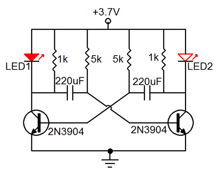

What should happen: (different circuit, but essentially the same still using npn transistors.)
