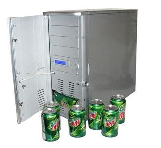

The thermal take chassis. This is a really nice case. One of the nicer things about this case is the lock you can see there on the side. This means you can keep your cold ones cold with some security from room mates or peeps in your dorm room.
With the key turned one way it locks the whole chassis, middle lets the main front door open, and turned the opposed way from the locking position lets you open the whole front bezel like a door. We will be doing a lot of modification to this area to accommodate both a dispensing hole, but also a way to refill the fridge as well.

With the ramps in place cut 2 holes in the back of the case and in the foam as well for the heat sinks. Just trace around them when you cut the foam, it doesn't have to be super precise as you can fill any gaps with the spray foam. Finally, wire the internal fans into the power supply lead. One other thing to note is the hole in the front of the case. We cut this out so the drinks can roll right out the front of the case. But as there is a cap between the inside and outer cases the cans come to rest in the gap nicely.
So the final assembly here is really important. I used glue, and some more glue, And finished up with more glue. So the process went something like this. I used some hot glue to glue the heat sinks to the case. With that done I then used some clear silicone to seal around the heat sinks so there were no air leaks. Then I used some artic silver epoxy to glue the inside heat sinks permanently to the peltiers cold block. (Make sure it's super clean or the epoxy won't stick.) Then I finished up with some spray foam on the inside. It was a really easy assembly. And the artic silver epoxy is super strong stuff and very thermally active stuff!
So with some foam glued to the inside panel and the wiring all done, all you have to do is plug the unit in and it's immediately hard at work cooling your cold ones just for you.
