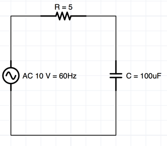

The circuit we'll be computing is a simple RC circuit. It has the following components:
- An AC power source of 10 Volts, running at 60 Hz
- A 5 Ohm resistor
- A 100 uF capacitor
The problem with this circuit is that the resistor offers a 5 Ohm resistance regardless of the frequency, while the capacitor will have a reactance that is frequency dependant. And to make matters more complicated, the resistor's resistance is a real number and the capacitor's reactance is an imaginary number.

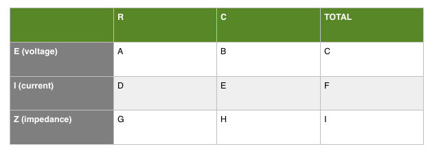

Your TI calculator has a whole bunch of memory locations. They are very handy to hold in-between answers. What I do (and learned from the excellent free books by Tony Kuphaldt, which you can find on the All About Circuits website) is scribble a table like this one on a piece of paper. The rows are used for the voltage (E), current (I) and impedance (Z) respectively. The columns list those values for the resistor (R), the capacitor (C) and the Total. Then I put TI memory locations in all the table cells. A, B, C, D, etc. for every cell. When I have entered a meaningful value into a memory location, I circle those letters so I know what I have already done. Just sayin'. Use your own preferred way of keeping track. If you're doing a more complicated circuit, simply add columns for the other components.

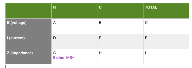

Step 4: The Resistor
The 5 ohm resistor represents a real number in our computations. In our table, we can see that we add its value to memory location G of our TI. If you've never attempted that before, the correct sequence is:

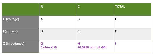

Step 6: Adding Impedances
Since this is a series RC circuit, you can simply add the impedance of the resistor and the capacitor. The complex sum of those two values (a combination of a real and an imaginary value) is now in memory location I. We won't check the polar values of this number. For now we will just leave the rectangular complex sum in memory location I and move on. If you finish this instructable, you can go back to this step and do it yourself.

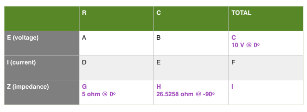

Step 7: Adding the Total Voltage
The total voltage is simply the 10 V from the AC power at an angle of zero degrees. So this is a real number and we can add 10 (volts) to memory location C.

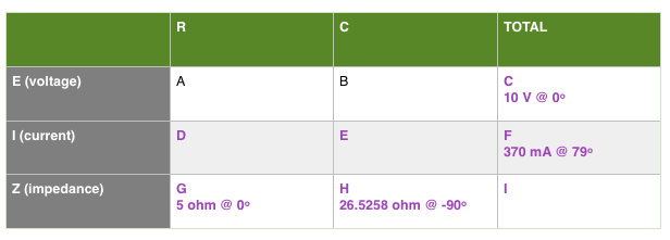

You can see that we now have entered four values into our table, of which three (C, G and H) were manually entered and one (I) was computed. We now have enough information to calculate the relevant missing values in the other table cells.

So we find out that 370 mA of current flows through our circuit.

So we find out our 370 mA of current has a phase angle of 79 degrees.
