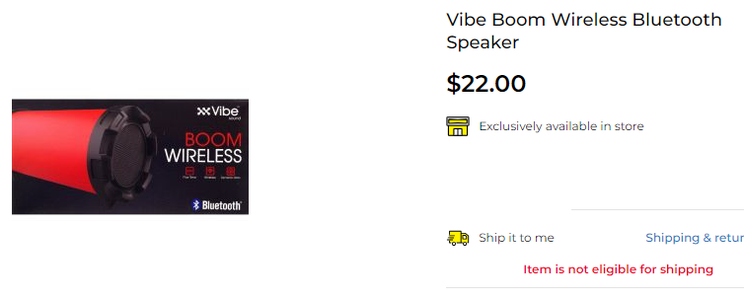

I started looking on Amazon for Bluetooth speaker kits. I wanted something that would work well with concrete, sound decent and be battery powered. I couldn't find anything to suit my taste. So I went to Dollar General and looked over their selection of speakers and came away with this Vibe Boom Wireless. Definitely not JBLs competition but it looked hackable.
