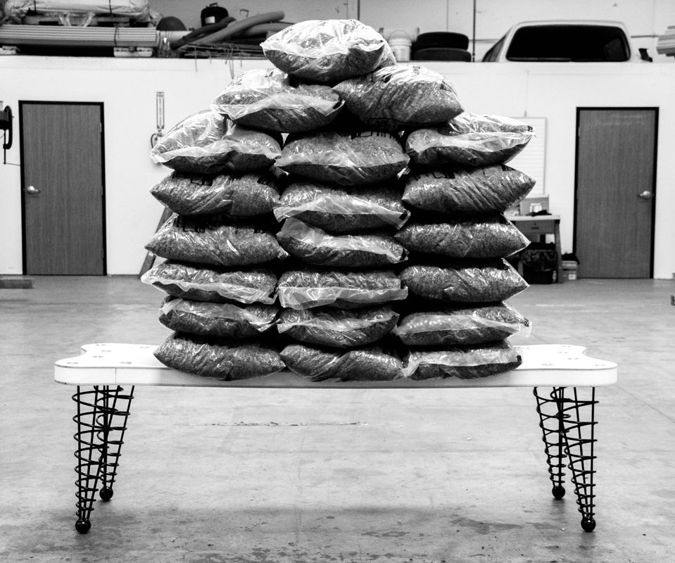

I built just one each, of the dining table, a computer table, and several coffee tables. My intention at the time was to make and sell these, I never succeeded in selling any, but I later decided to make and sell the legs, which can be seen at SpiralConeLegs.com
The table top is 1-inch thick steel reinforced concrete.
