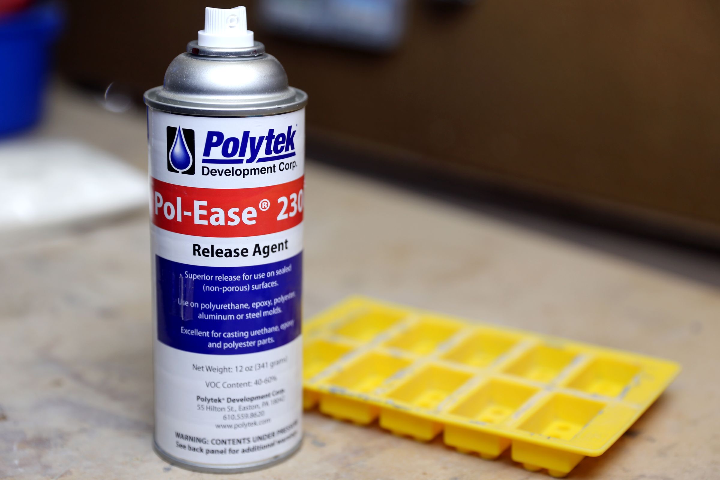

Before pouring your concrete mix into the molds it's a good idea to use a release agent, this will make removing the concrete from the mold after it has cured very easy.

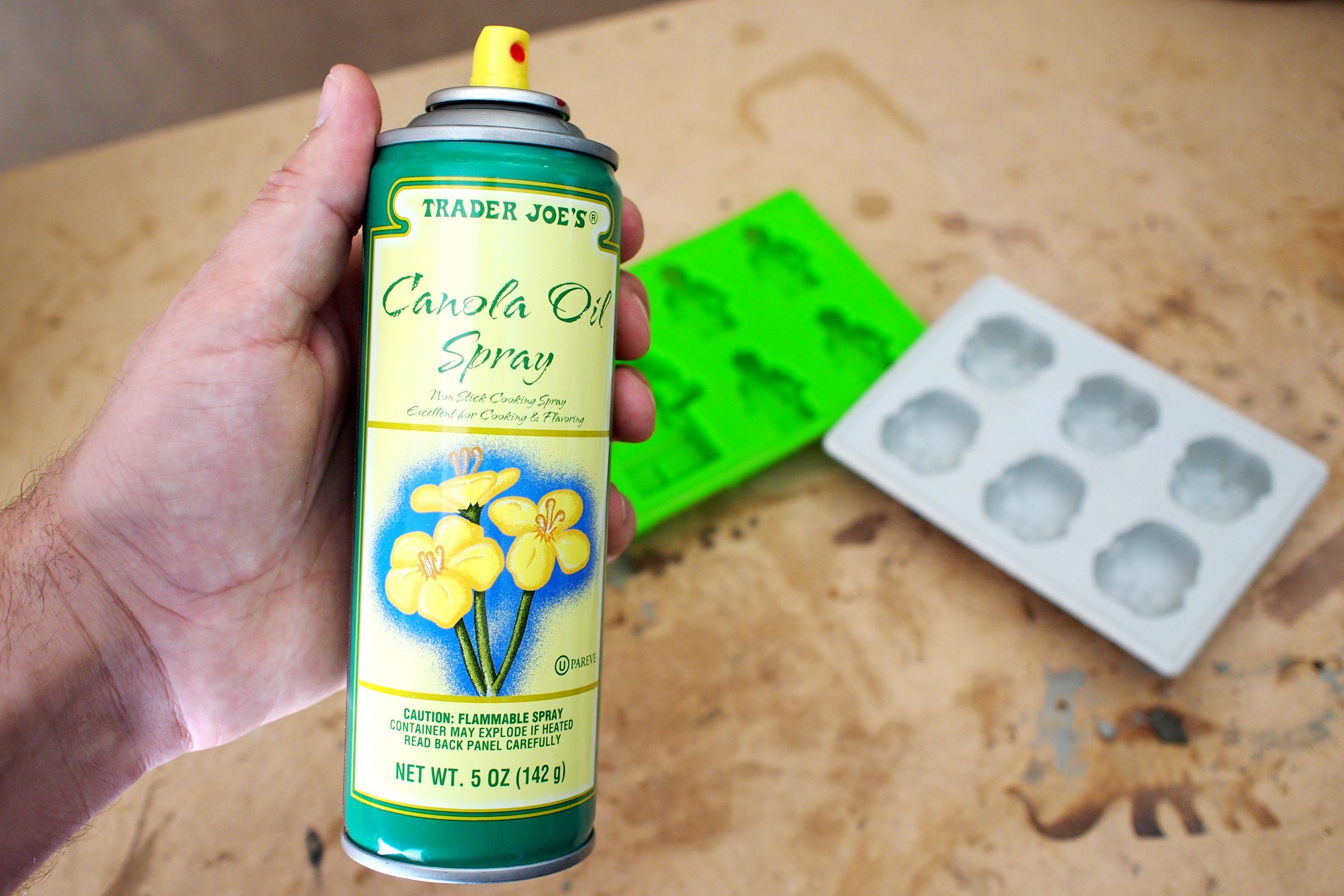

There's special concrete release agent, like Pol-Ease 230, but ordinary cooking spray works just as well.
Spray the release agent into the mold, ensuring coverage in all nooks of the mold. Careful not to spray so much that the release agent pools and causes drips.

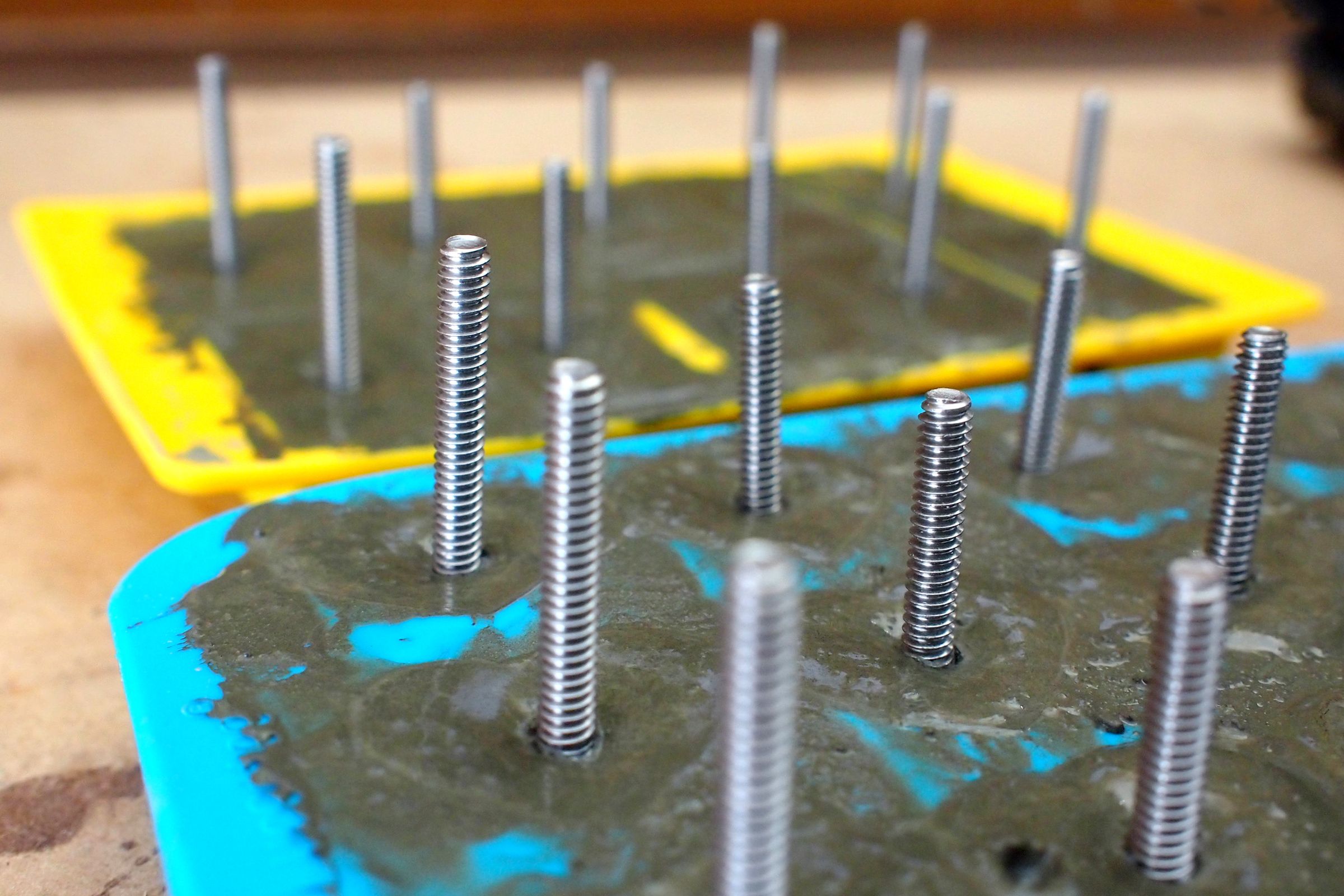

After vibrating the molds free of bubbles the mounting hardware can be added.
I used 2" fine thread machine screws with a flat hexagonal head as the mounting hardware for my drawer pulls. The hexagonal heads were gently pushed into the center of the mold.
The machine screws can stand on their own. Repeat inserting machine screws for every mold segment, ensure you don't get any concrete on the top of the machine threads.

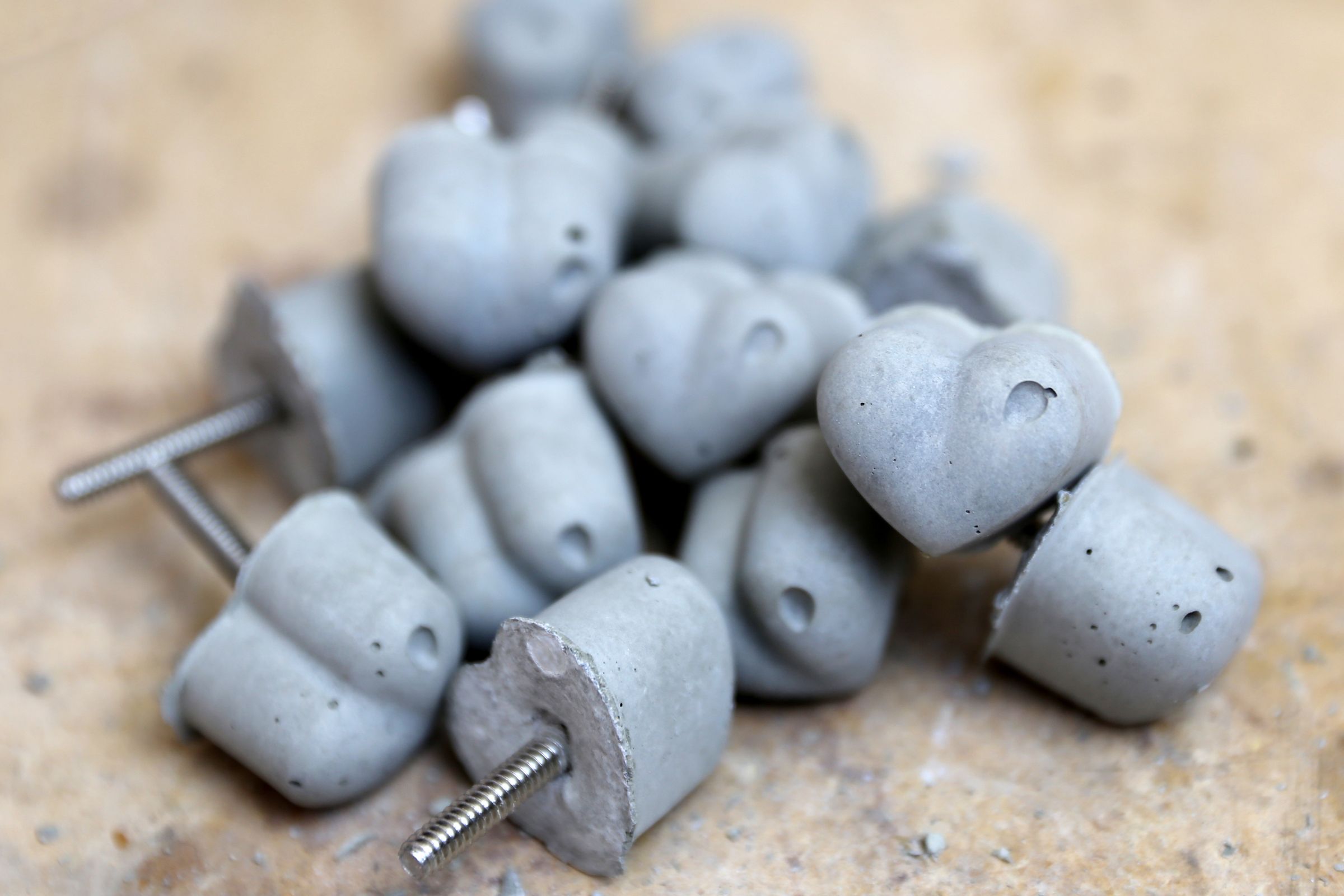

After 24 hours the casts can be removed from the molds.
Silicone molds are great as casts can be easily removed by flexing the silicone and pushing from the underside.
Step 7: Remove Flashing
Any over-pour of concrete will set around the backside of the casting, this excess pouring is called flashing and can easily be removed.
Since flashing is so thin it can be broken off with your fingers, after the edges can be smoothed over with 120 grit sandpaper.

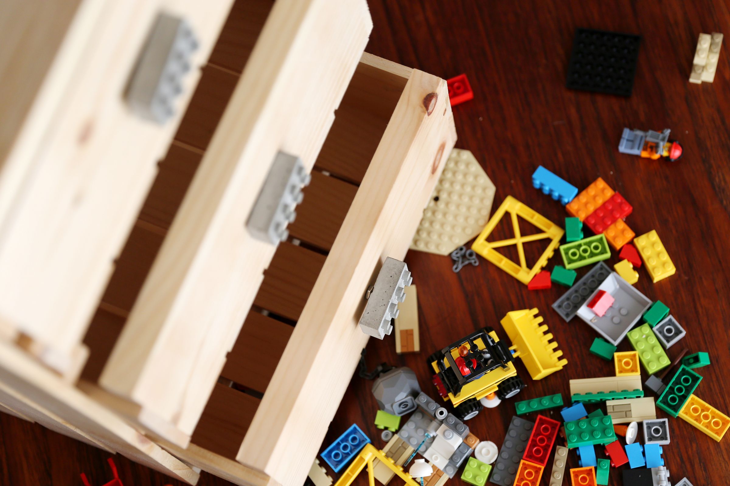

Step 8: Install Pulls

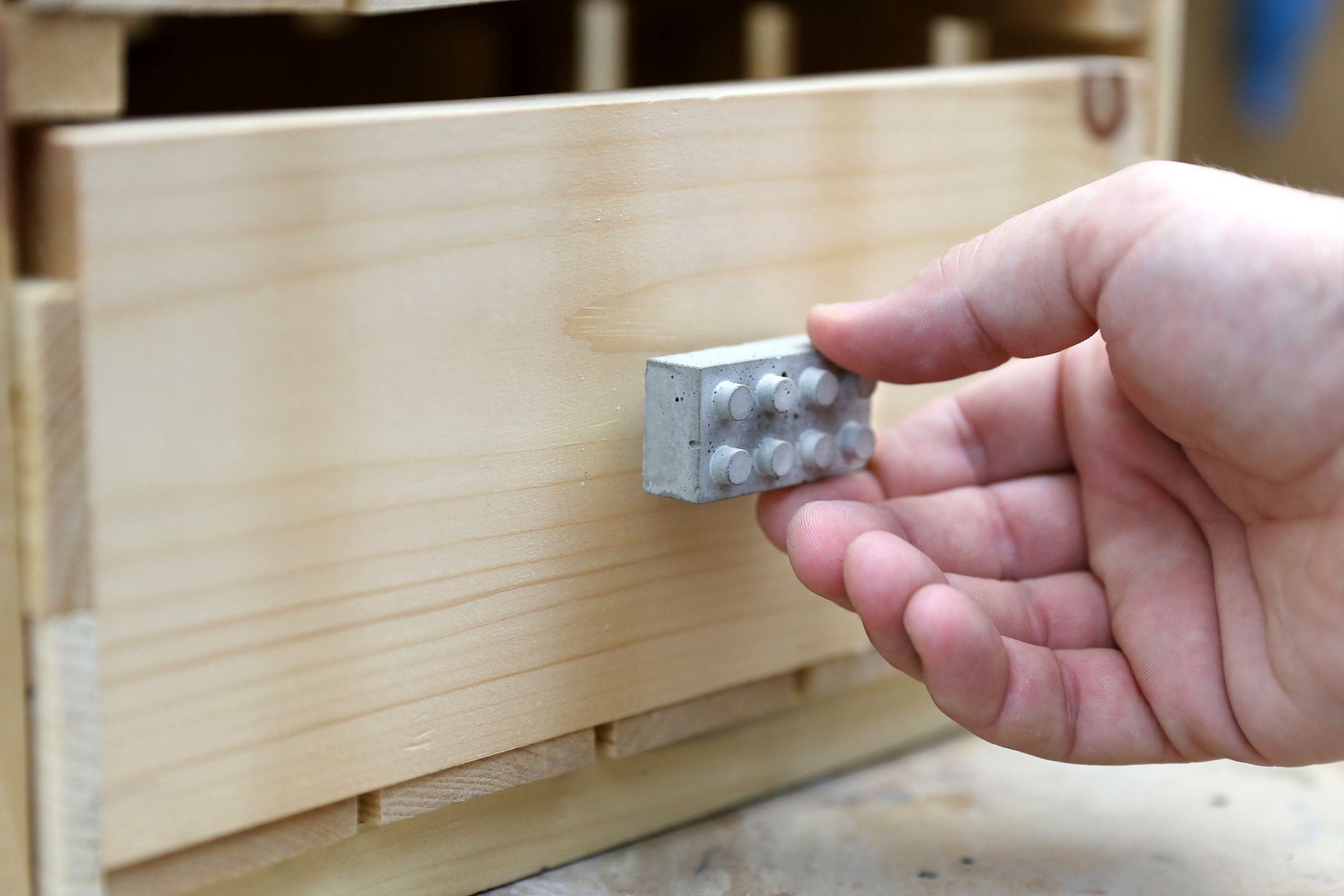

If your drawers didn't have pulls before you'll need to drill an opening to match the diameter of the screws you used.
Since the threads go all the way into the concrete I found it nice to add a nut onto the threads first before installing into a drawer, then adding another nut after installing to hold it in place. The first nut can be adjusted to give the pull as much clearance as you need from the front face of the drawer so it can be easily grabbed.
