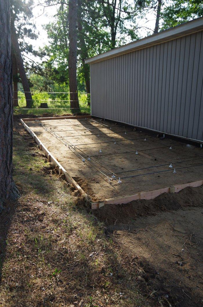

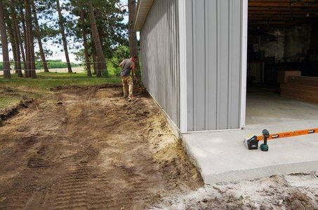

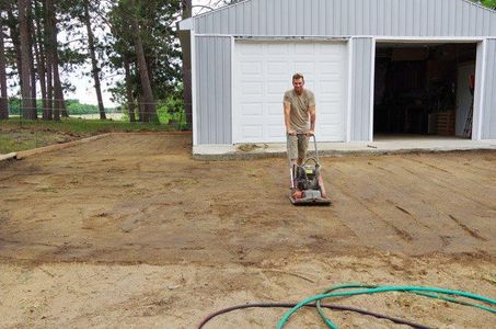

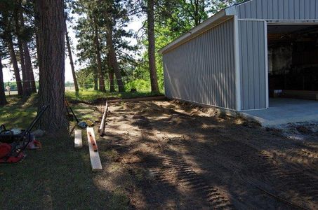

Concrete forms are NOT hard. You can see we already had a half assed L shape going on with 2x6s to help us get the grade correct. Now we perfected those 2x6s using stakes, our four foot level and measuring out from the garage about a thousand times. Lodi completed the full rectangle with 2x6s and secured everything really well. Here’s probably the best reason as to why we decided to do this in three pours instead of one. Besides the fact that we’re a little army of only TWO, doing the slab first means that we could put our frames all the way around it and really do it right.
Step 1: Forms and Rebar
Then, later, we can remove our concrete forms and connect our next pour (our new apron that’s going all the way across our addition and the existing garage) directly to this new slab as well.

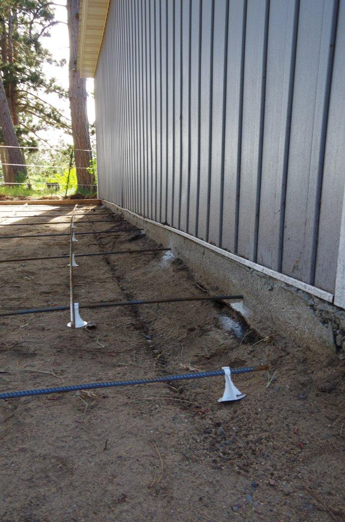

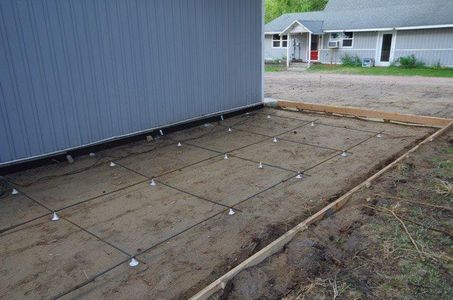

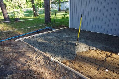

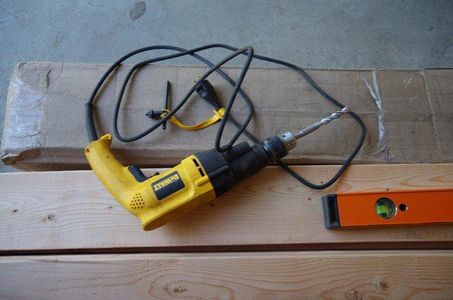

Our next step was more shovel work as we needed to dig a four inch deep trench around the entire inside of the frame. This “footing” will give us a thicker slab where our walls will sit and it will help stabilize the rest of the slab. From there we borrowed a hammer drill from a friend of ours and got to putting a 1/2″ size hole into the old slab every couple of feet. 1/2″ rebar is a little larger than that requiring us to pound it in and guaranteeing its not going anywhere. You might be able to get this done with a regular drill… but you would probably regret it. Borrow (or rent) a hammer drill for concrete work and get decent masonry drill bits. Inside of our concrete forms we laid our rebar down on their little stands every three feet and then lengthwise as well. We attached the overlapping rebar together with wire. The majority of our slab will be four inches deep so we ordered two inch tall rebar stands.

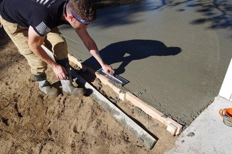

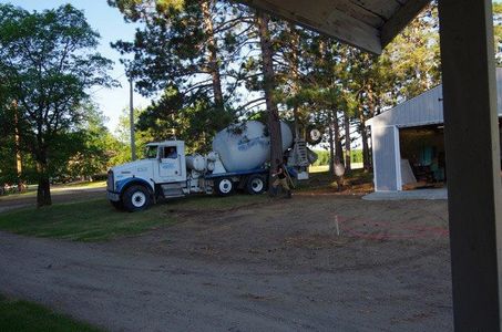

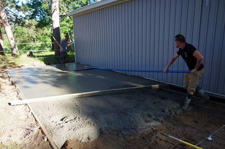

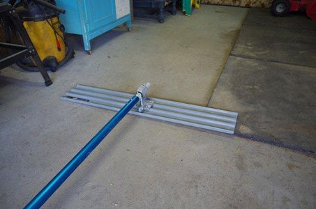

Bright and early Saturday morning (both wearing clothing we had no interest in saving) it was time to pour our new slab! We had one helper with shovels and rakes who got in there with Lodi while I helped from the outside running the scree with him. I can’t take any credit for any of this honestly – Lodi handled it all, built the concrete forms, prepped it all and gave me instructions on how to help where I could. He did an AWESOME job. We rented a bull float which is pretty much absolutely mandatory for any slab.

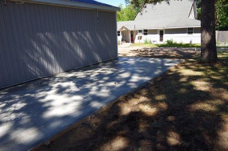

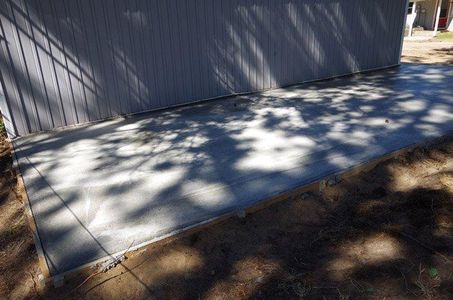

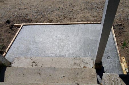

Like with any concrete pour there was extra in the truck that we were prepared for.
Lodi built concrete forms in front of our front step and even up in front of the barn door. There was just enough to make the front step a lot better – when we pour the slab for the apron next weekend we’ll use that extra up at the barn. And then when we do the third pour to finish the apron that will give us extra for a bottom step over by our deck. In a couple of days we’ll pop off our forms so we can reuse those 2x6s for our concrete apron! PHEW! Of course we just had to date our new step, put our hand prints in it and even added Annie’s paw print too. (Note: Concrete is insanely toxic, get it off your skin or, in this case, washed off your dog’s paw immediately!)
