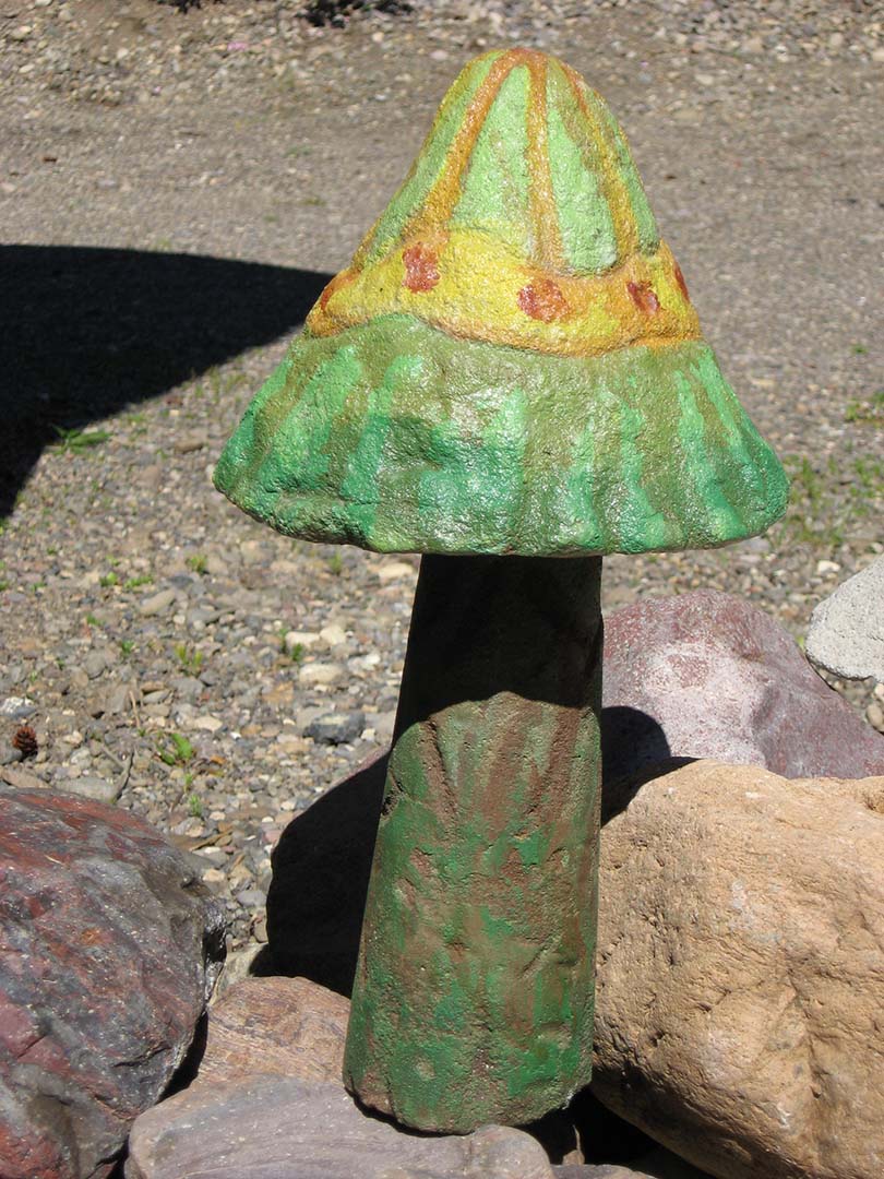

Step 4: Finishing Mushrooms
  1. Once the Quick Crete has set, peel off of the tarpaper from the stem and lift your mushroom carefully out of the cap container. It should be solid and stuck together well. If not, you can use some extra Quick Crete to glue it in place.
  2. You can carve into the mushroom cap and stem if you desire to shape them a little bit more - on the little agate mushroom (picture 3) we carved the edges of the mushroom cap for a fairy look Some of the larger mushrooms have carved stems.
  3. The Quick Crete bag instructions suggests that you should cure your concrete, but we did not do this. We left the mushrooms standing in the yard and occasionally watered them with the sprinkler. Some of our mushrooms have been outside in our northern yard and gardens for 2-5 years and have never cracked or disintegrated (This project is so fun - we've done it multiple times!).
If you like the look of these mushrooms, that's it! You're done! If you want to embellish a bit more, continue on to the next step.
Step 5: Embellishment
Make sure that your mushrooms are completely dry. Once they are, you can use acrylic paint to make more colourful mushrooms. Once you've painted them, spray them with clear outdoor satin base varathane.
