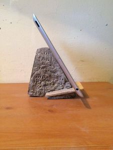

Step 1: The Mould
Step one - Making the mould
The mould consists a piece of ply wood, and duplex board. Remember to fold the card such that the surface with the graphics on should be facing up.
I have added a diagram of the type of mould I uses. Feel free to check that out. If not, then here it is. Draw a trapezium that is 3cm high, with a bottom of 5.5cm and a top of 4.5cm. Add on a rectangle at the end that is 4.5cm that is 5.5cm by 15cm. Add a rectangle to the side of the trapezium that is 5.5cm. Make it 5.5cm by 13cm. Add a rectangle to this side that is 5.5cm by 13cm. Its now time to create the side panel. Do this by drawing the template provided.

Step three - Pouring the concrete
Place some of the concrete bit by bit until 1/4 of the mould is full. Tap gently just to release a few bubbles caught in the bottom. This also helps the concrete spread. Place more of the concrete mix into the mould until it is half full. Place the Ply wood into the slot and then continue to add concrete until you have reached your limit.
After one of two days, the concrete should have set. However, It takes 28 days to get to its full strength. Be careful when taking off the mould. I used a small file to get rid of bits of concrete that I didn't want and used sand paper to get rid of flashing.
