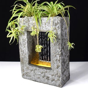

In this instructable, I show you how to make a rainfall fountain with an original design. In this fountain, there are a planter, 2 Chlorophytum plants, and an illuminated basin. Everything is made only from cement, polystyrene foam, and sand. It’s fun to make and you can use it as an awesome decoration indoors or in your garden.

Step 1: Basic Shape
I start by cutting 4 polystyrene panels in order to have the dimensions 40x54cm. All panels are 4cm thick. The only tools I have used in this operation are a metal ruler and a simple cutter. For a clean and easy cut, it is essential to use a new cutter blade and to cut the polystyrene slowly and with great delicacy.
Then, I open a rectangular window of dimension 23x30cm in each panel.

Step 7: 1st Concrete Layer
We move on to the preparation of the concrete mix. In this whole project, I follow the same ratios of the mixture: 2.5 cups cement +1 cup sand + water. Only I vary the quantity of water to arrive at the consistency of the desired mixture. Always the first layer of concrete is the most diluted.
In the first layer, I pour the diluted concrete over the sand mold. We gradually cover everything with concrete.
I used a large-scale brush to coat all of the polystyrene foam with concrete.
Step 8: 2nd Concrete Layer
After drying, we move on to the second layer of concrete. The concrete mix of this layer is less diluted. Be sure to cover all the 1st concrete layer with the same thickness. I used a masonry trowel in this step.
Step 9: Texture
After 24 hours of drying, I added texture to the smooth walls of the fountain. I used the same brush used for the 1st concrete coat. Using this brush, the concrete is applied to the smooth surfaces in a discontinuous and random manner. After an hour, lightly pass the masonry trowel over the texture achieved.

Step 11: Plant
To put the plants in their pot, we start by filling half the pot with the appropriate soil. Then I gently put the two plants in the pot and then add the necessary amount of soil in the ends and in the center of the plants.
I chose to put the Chlorophytum plants because I like them a lot :)
Step 12: Start-up
To put the fountain into operation, it is necessary to start by pouring a quantity of 1.5 litres of water into the basins.
