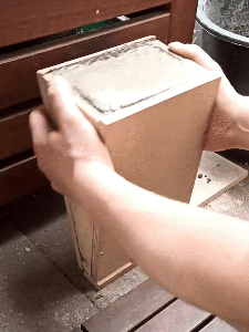

In my case, the steps are 10cm high. A slope needs to be small enough to make lifting a bike easy. The ramp block cannot be too big (too long). After some checkings, I've picked a length of ~27cm what gives an angle to be ~21 deg. The width of the ramp is 15cm.
To build a frame for such a block we need 5 pieces:
  • 1x bottom: 260mm x 174mm (174=150mm internal width + 2 * 12mm width of plywood)
  • 2x sides: triangle with cut corner: 260mm (bottom) x 100mm (height) x ~20mm (cut corner)
  • 1x top: 280mm x 174mm
  • 1x front (part at cut corner): 174mm x ~30mm
The cutting is straight forward.
Step 2: Assembling a Frame
Attach as many screws as reasonable. Initially I've added 2 screws on each side. But concrete is really heavy. It means it may split the parts just by it's weight. So later on I had to attach 2 more screws to keep the frame in a shape.

Step 7: Taking a Ramp Out of the Frame
Normally a ramp blocks can be easily removed from the frame. Some delicate smashes with a rubber hammer does the job and the block pops out from the frame.
Occasionally I had to unscrew the sides of the frame. On a last photo you can see the last 4th ramp where I disassemble the frame completely (as I didn't need a frame anymore).
