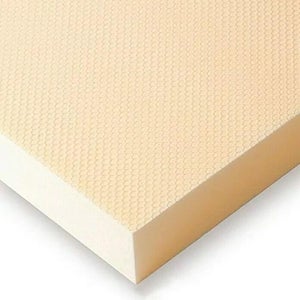

  • Hard foam plate 125 cm x 60 cm x 40 mm (https://www.bauhaus.info/hartschaumplatten/ursa-hartschaumplatte-xps-d-n-iii-pz-i/p/13893104)

Step 1: The Mold
First, the mold is milled with the help of my shapeoko 2 CNC.
I have chosen the flower of life as a motif.
The hard foam plate is glued to the milling table with the help of the double-sided adhesive tape.
Then I milled the mold with the help of EstlCam.
