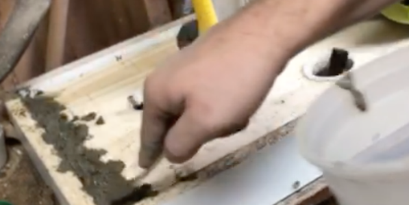

Pour the concrete into your form and then press your board into the concrete.
I did not add enough concrete to go all the way up the sides of the board, so I made a thinner mixture (aka slurry) and pushed it down the sides.
I then added some weight so the board didn't float. You will want to let this dry for at least 24 hours.
