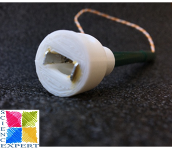

In the manufacture of a two-electrode probe for a conductivity meter, the following materials are required:
Components for two-electrode probe production
- The solvent glue or contact glue which exhibits a rapid setting time. The substance facilitates the adhesion of components while simultaneously ensuring the watertightness of the seal.
- A DIN 72581 fuse. It is advised to employ a utilised fuse to refurbished it.
- A previously used and now unusable pen or felt-tip pen may be employed. The tube will be retained to construct the body of the probe.
- The probe head will be 3D-printed according to the dimensions of the blades of the fuse and the diameter of the felt-tip pen or pen.
- Additionally, copper wires are required. The aforementioned cables are derived from a LAN cat5E cable, which is no longer in used due to its incompatibility with the current specifications.
- The requisite materials include tin, a soldering iron, and the necessary connectors.

In a practical sense, the decision was taken to use blade fuses, which are commonly employed in the automotive industry and which meet exacting standards (DIN 72581) in terms of both their dimensions and their surface chemistry, namely silver/zinc or tin/zinc alloy. Furthermore, the utilisation of refusbish fuse is recommended, as it is a valuable asset to this project [[iii]].
Figure 9 : DIN 72581 fuse
The surface chemistry precludes the possibility of tin soldering. However, the apertures on each of the blades will permit the attachment of a connection wire. The remaining requisite materials will be 3D printed in PLA, as the dimensions of the electrodes for the fabrication of the probe head and the body of the probe are already known. Alternatively, recycled materials may be employed for the latter component.
Figure 10 : The conductivity meter probe head is 3D printable using PLA. (a) Electrode housing. The distance between the two electrodes is 1 cm. The cable passage body housing is shown in (b), while the solute flow port is shown in (c).

The first step is to take the blades out of the fuse and connect them to the wires thank to the blade holes as below :
Figure 12 : DIN 72581 fuse connection
Prior to inserting the electrodes into the housings provided for this purpose in the probe's head, the connections are bonded and made watertight with a quick-setting solvent glue in order to prevent contact with the solution. An excess of glue is added in the cable passage in order to create a seal. The tube of the felt-tip pen or pen is then bonded into the housing in order to form the probe's body.
Figure 13:Housing of the blade and final conductometry probe
The assembly is completed with the appropriate connectors for your conductivity meter.
