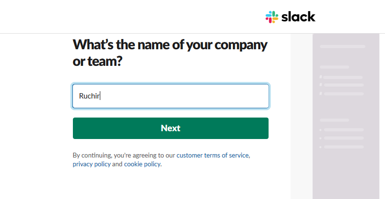

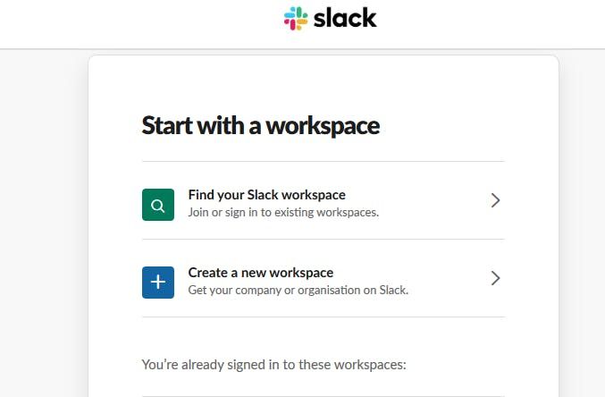

- First go to https://slack.com/intl/en-in/ then enter your email address. You will see page like this
- Create a new workspace. You will see page like this

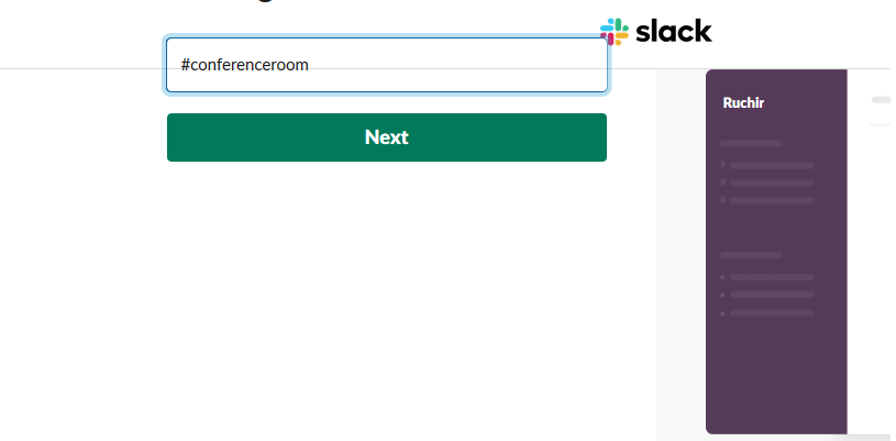

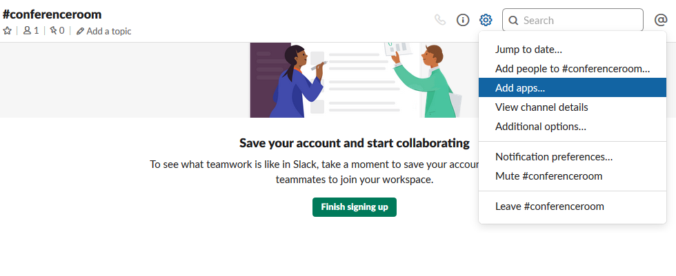

- Make a channel for the Webhook to post in. I created a channel name called #conferenceroom.
- Next, click the gear icon and choose “Add an app”.

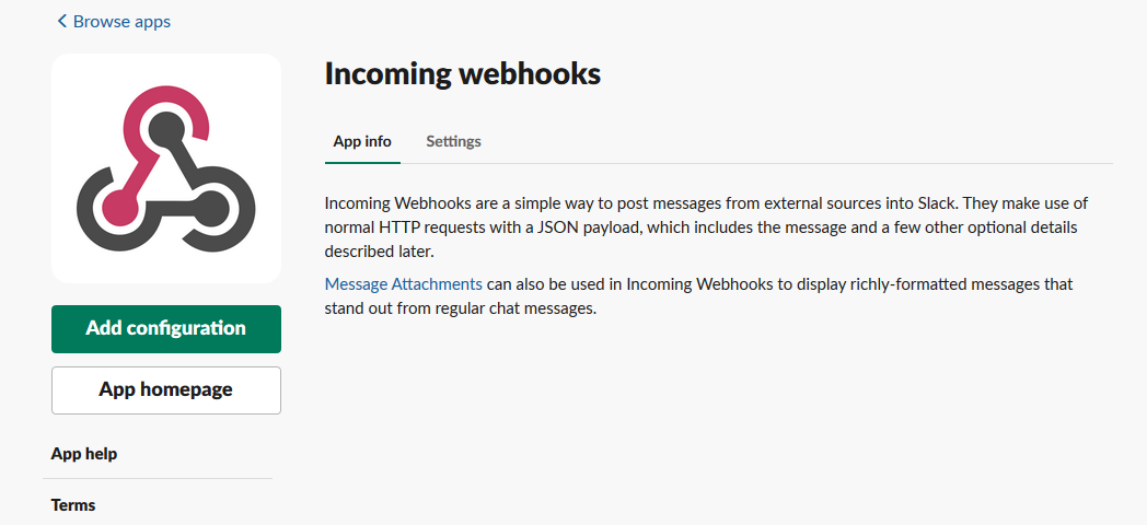

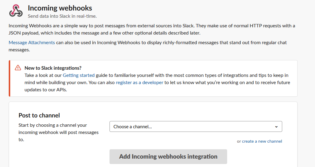

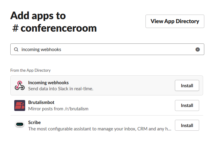

- Now, create the Webhook itself. Type incoming webhooks into the search box, then click Incoming WebHooks.
- Click on the incoming webhooks you will see page like this
- Then click on "add configuration". You will see page like this
Choose a channel to post to. In this case, it’s #conferenceroom

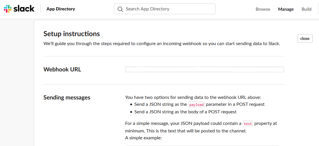

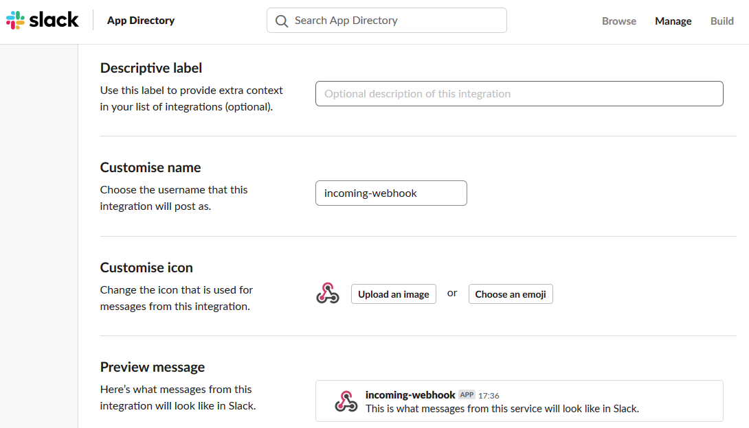

- Locate your Webhook URL. This URL send data to via the Particle Device Cloud.
- Scroll down to Integration Settings and give your webhook a descriptive label, name, and icon, then click Save Settings.
We are done with Slack setup.

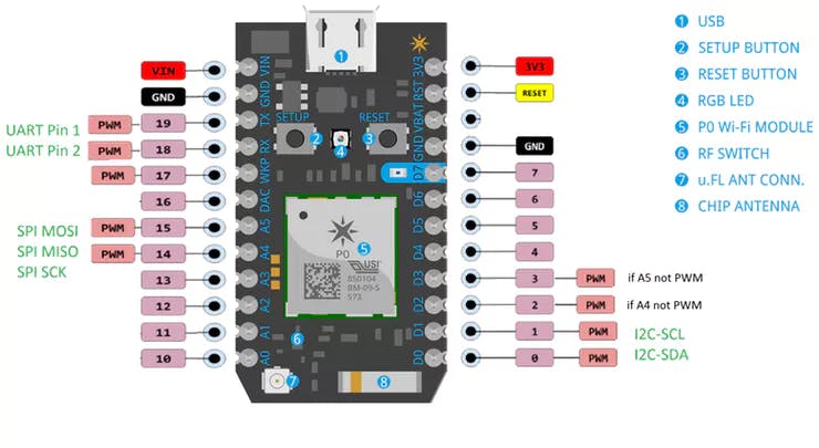

Step 3: Particle Photon

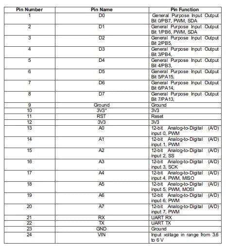

Photon is a popular IOT board.The board houses STM32F205 120Mhz ARM Cortex M3 microcontroller and has 1 MB flash memory, 128 Kb RAM and 18 mixed signal general purpose input output (GPIO) pins with advanced peripherals. The module has on-board Cypress BCM43362 Wi-Fi chip for Wi-Fi connectivity and Single band 2.4GHz IEEE 802.11b/g/n for Bluetooth. The board comes equipped with 2 SPI, one I2S, one I2C, one CAN and one USB interface.
It should be noted that 3V3 is a filtered output used for analog sensors. This pin is the output of the on-board regulator and is internally connected to the VDD of the Wi-Fi module. When powering the Photon via VIN or the USB port, this pin will output a voltage of 3.3VDC. This pin can also be used to power the Photon directly (max input 3.3VDC). When used as an output, the max load on 3V3 is 100mA. The PWM signals have a resolution of 8-bit and run on a frequency of 500 Hz.
Pin Diagram
Pin Description

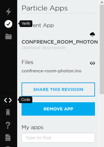

Web IDE
Particle Build is an Integrated Development Environment, or IDE that means that you can do software development in an easy-to-use application, which just so happens to run in your web browser.

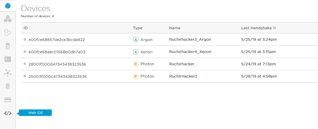

- To open build, login to your particle account and then click on Web IDE as shown in image.
- Once you clicked you will see console like this.

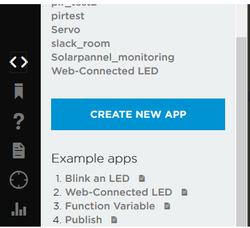

- To create a new create app, click on create new app.
- To verify the program. Click on verify.

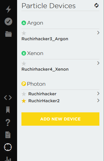

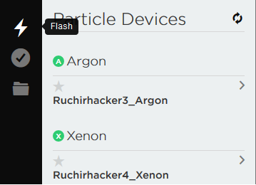

- To upload the code, click on flash but before doing that select a device.If you have more than one device you have to make sure that you have selected which of your devices to flash code to. Click on the "Devices" icon at the bottom left side of the navigation pane, then when you hover over device name the star will appear on the left. Click on it to set the device you had like to update (it won't be visible if you have only one device). Once you have selected a device, the star associated with it will turn yellow. (If you only have one device, there is no need to select it, you can continue.

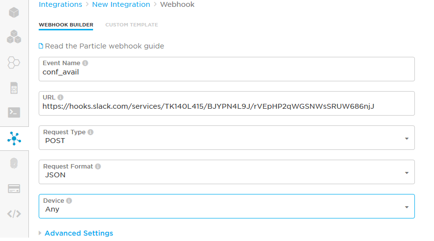

Step 5: Create a Particle Webhook
Many Slack integrations require dedicated web servers running PHP scripts to process information to and from Slack. However, in our case we just use a Particle webhook to tell the Slack webhook whether the conference room is available or not.
We need two webhooks one for conf_avail and second for conf_inuse (you can use any name).

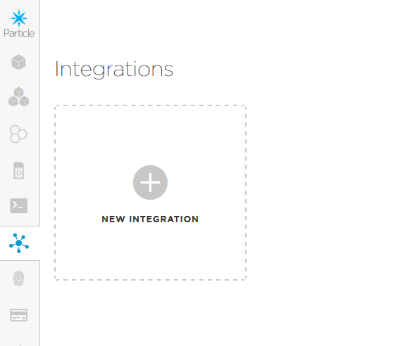

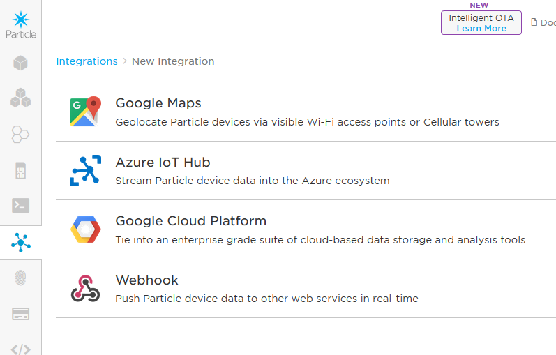

- Go to the Particle Console and click the Integrations tab, then click New Integration.
- Click Webhook to start the Webhook Builder.

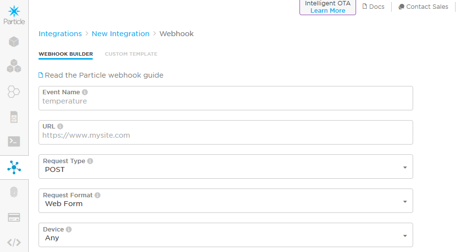

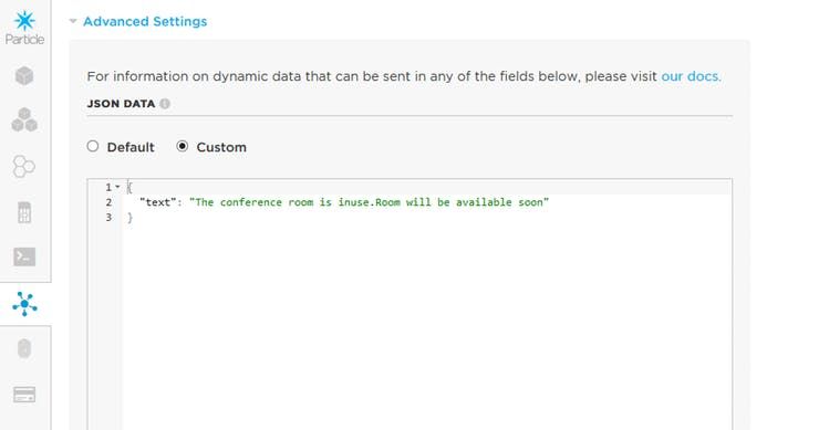

In the Webhook Builder under Event Name enter conf_avail. Paste your Slack webhook URL under URL. Change Request Format to JSON

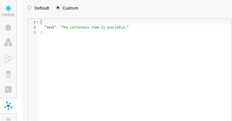

Expand Advanced Settings and choose Custom under JSON Data. Paste the following code
{ "text": "The conference room is available."}

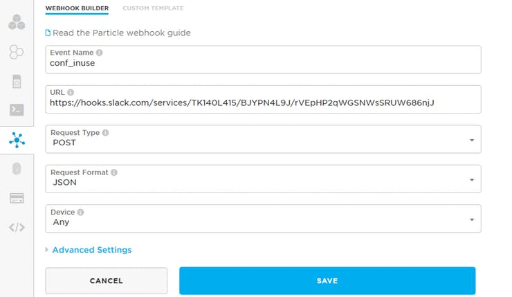

Repeat same steps for conf_inuse

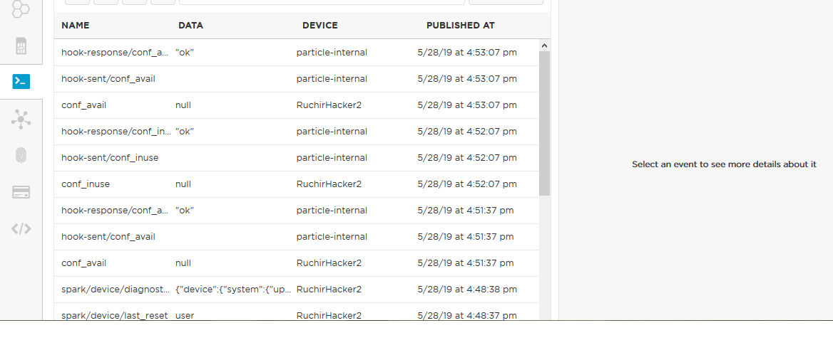

Note :- The name of the event being published matches the event name parameter in the webhook.

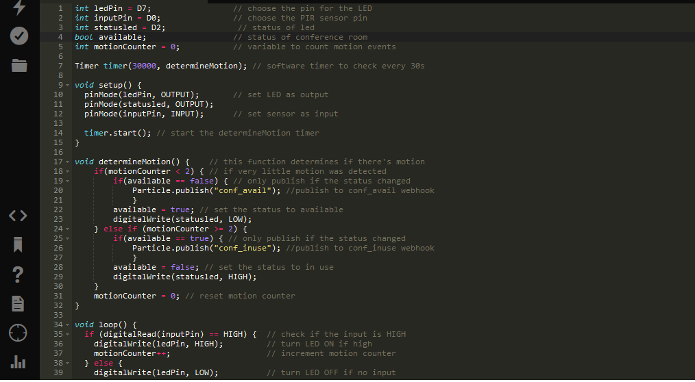

Step 7: Program

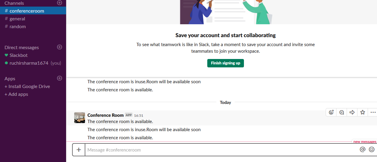

Step 8: Result
