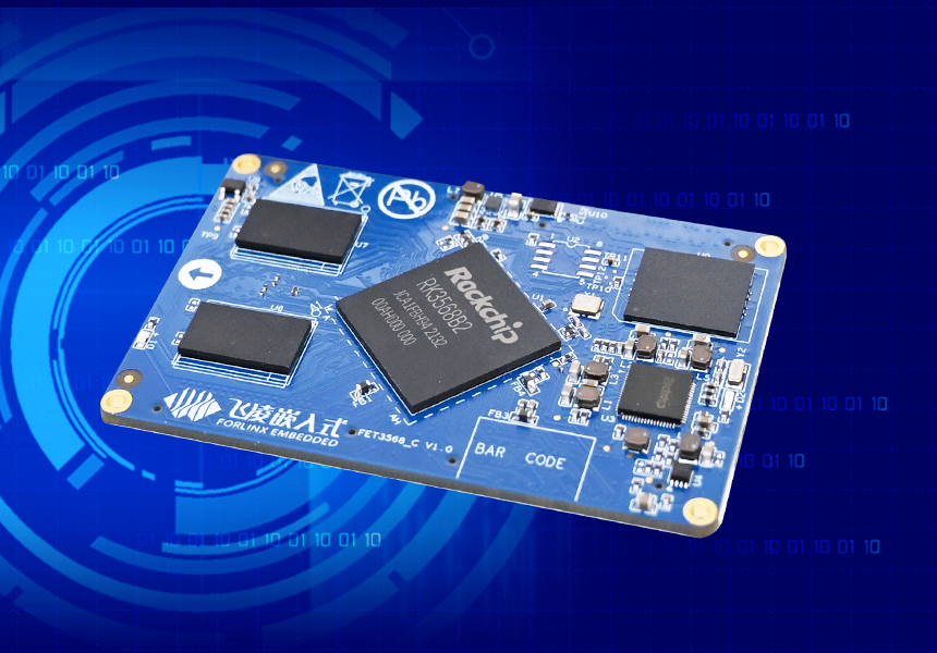

Introduction: Configuration and Debugging of PCIe Endpoint (EP Mode) on OK3588-C Linux 5.10.66 Buildroot
This article will provide a detailed introduction on how to complete the kernel configuration, U-Boot settings, and performance testing of the EP device on the RK3588 development board, helping developers quickly set up an efficient and stable PCIe Endpoint environment.
Step 1:
The document testing is based on the RK3588 development board.
  1. During the testing, both the RC (Root Complex, host device) and the EP (Endpoint, peripheral device) are Linux devices (RK3588 development boards).
  2. This article focuses on describing the configuration and testing process of the EP device. For detailed configuration information, please refer to the document: Rockchip_Developer_Guide_PCIe_EP_Stardard_Card_CN.pdf.
  3. Software:Linux 5.10.66 4G+32G
Kernel version: OK3588 linux 5.10.66 version kernel (Android12 Linux ForlinxDesktop20.04 R5 release)
Uboot version: OK3588 protection encryption uboot (Android12 Linux ForlinxDesktop20.04 R4 release)
Step 2: Hardware Connection
For the hardware connection, only one PCIe 3x4 lane male-to-male extension cable is required.
