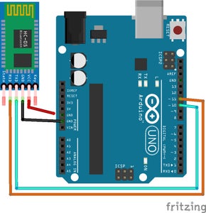

Circuit Connections:
  1. Connect the Female end of all the Male to Female wire to the VCC, GND, RX and TX pins of the HC-05.
  2. Connect the GND of HC-05 to the GND of Arduino Board.
  3. Connect the RX of the HC-05 to Digital Pin 11 of Arduino Board.
  4. Connect the TX of the HC-05 to Digital Pin 10 of Arduino Board.
  5. Leave the VCC Pin Floating.
  6. Now keep reset of Bluetooth module pressed and connect VCC to Arduino VCC.
  7. The Bluetooth LED should blink every 2 seconds. This shows that the BT is now in AT mode.
