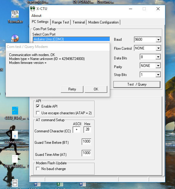

Step 4:
Once the connections are made open the Xctu software and use the test to detect the Xbee attached. If "All is well" then you should see the device is of the xbee attached if not don't worry change your baud rate to 115200 and check. If this also doesn't work please do leave your comment I will try my best to help you out /\.
If the device is detected now move to modem configuration tab and select the always update firmware and click on read , this will read the current configuration of the modem mostly it will be in router mode, in this case it's in API mode as I have configured it so.
