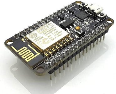

Now let's move on to the hardware part, we'll connect some LEDs to the esp32 you can use the esp8266 as well it works with both. I connect led1 to pin 18, led 2 to pin 19, and the last LED goes to pin 21. All the LEDs connected with a 1 kilo ohm resistor. Then I connect the ground to the LEDs then connect the esp32 to you computer
