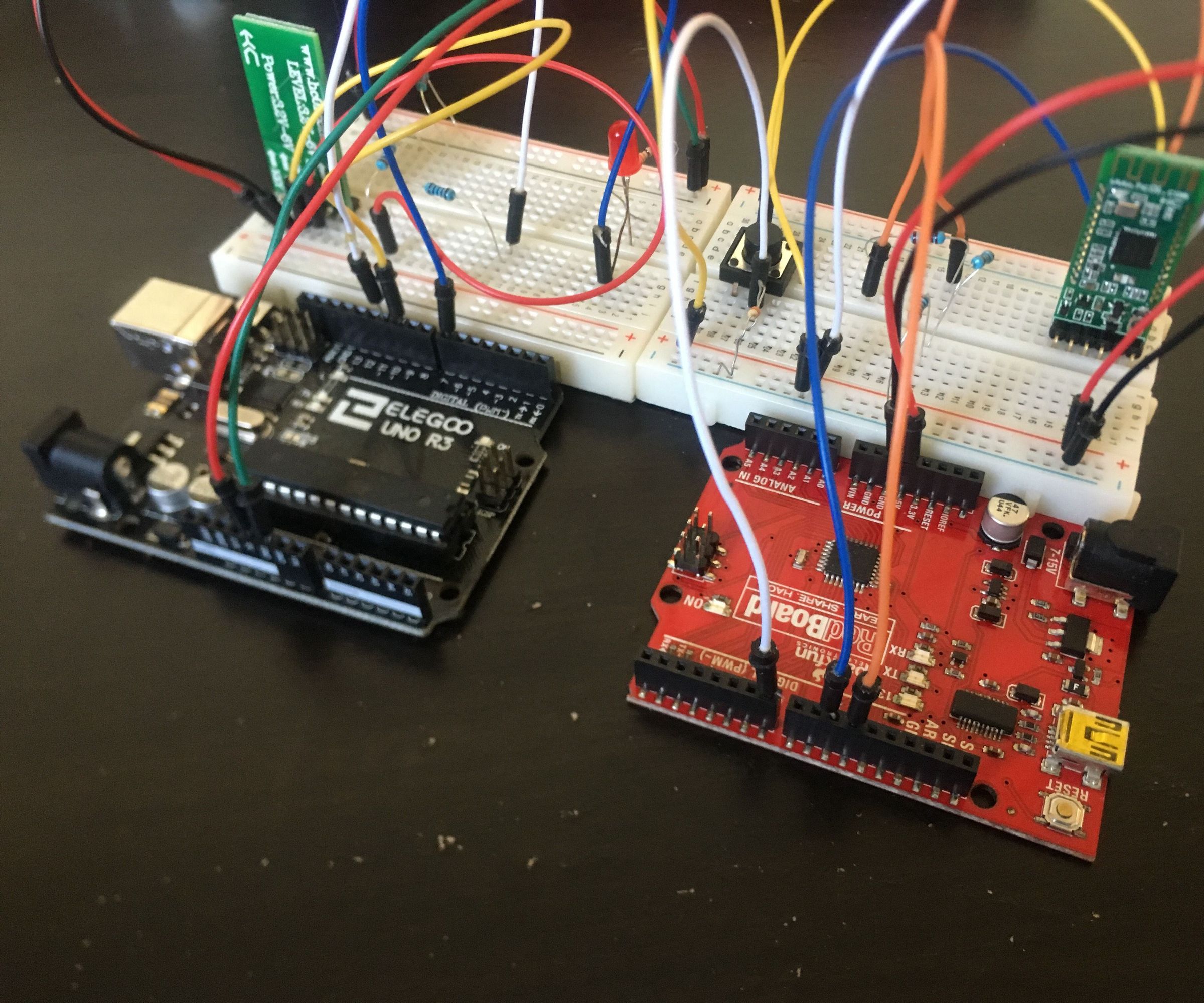

Step 8: Connecting the Arduinos and Testing
To test the bluetooth connection, start by disconnecting the Slave device from any others (such as your Android), and then setting up the Master HC-05 in "normal" transceiver mode. To debug, it may be wise to keep the Slave Arduino connected to your PC, with the Serial monitor running. Power up the Master Arduino using a 9V battery and Arduino DC jack connector, placing it a distance away from the Slave. The two devices should connect automatically, which can be indicated by the onboard LED, which should blink twice every 2 seconds.
To test the device, press the push button. The LED should turn on as long as you hold the button down.
