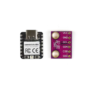

Step 1: Make a Connection
Utilize 4 jumper wires to connect the device as shown.
