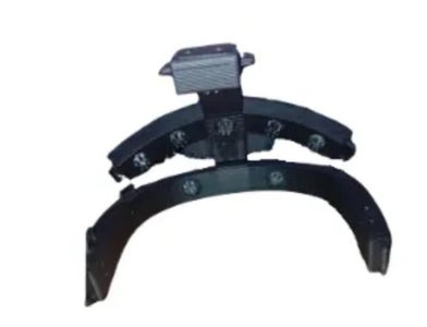

We used a brain-computer interface — ironbci [5], with data transmission via BLE5 to a mobile application. This is an 8-channel interface with a data acquisition rate of 250 samples with an internal noise of about 1 µV.
A standard connection with two ear-clip electrodes was used — one serving as the reference and the other as the active electrode. Since the provided dataset included only two electrodes, we also limited our recordings to two electrodes. Dry electrodes made of silver/silver chloride (Ag/AgCl) were employed, without the use of conductive gel.
