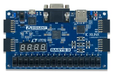

In our project, we use a BASYS3 board and displayed our game via VGA on a monitor.
BASYS3 features
- 7 Switches used to select which column you place the chip in.
- 1 Button used to place a chip after you select which column you want to put it in, using the switches.
- 1 Reset Button
- VGA connector
