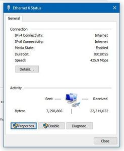

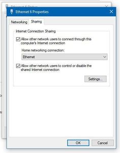

This step explains how you can share your laptop internet with the Raspberry Pi via Ethernet cable. In Windows: To share the internet with multiple users over Ethernet, go to Network and Sharing Center. Then click on the WiFi network.
Click on Properties (shown below), then go to Sharing and click on “Allow other network users to connect”. Make sure that the networking connection is changed to the connection of the Raspberry Pi. In my case, it is Ethernet.

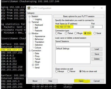

Step 4: Finding IP for PuTTY Configuration
By default, the laptop will give a dynamic IP to the Raspberry Pi. Thus, we have to find out the IP address of Pi now.
As shown above, the IP assigned to my Pi is 192.168.137.144. To check the IP assigned to the connected Ethernet device, do the following. Considering that the IP assigned to your Pi is 192.168.137.144 and the subnet mask is 255.255.255.0.
  1. Open the command prompt.
  2. Ping at raspberrypi.mshome.net.
  3. Stop the ping after 5 seconds.
Here, it is 192.168.137.154. Note this somewhere.
Step 5: PuTTY Configuration and VNC on Raspberry Pi
  1. In the Host Name, enter the IP Address we noted from the command line.
  2. Ensure that the Connection Type is SSH.
  3. Hit Enter or click on Open to proceed.
  4. Now, a new window will open. It looks like a normal terminal window of the computer but it is Raspberry Pi's terminal window accessible on your laptop.
  5. It is display- login as:
  6. Enter pi as the username.
  7. Enter the password you set for the Raspberry Pi. The default password is raspberry
  8. If the password is correct, the Pi will load and you will access the terminal window of the Pi.
  9. Now, you need to start the VNC Server. Enter after the $ sign - sudo vncserver :1
  10. This is to initialize the VNC Server on the Raspberry Pi.

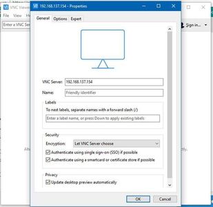

Step 6: VNC Server and VNC Viewer on Laptop
Now, Raspberry is ready to connect using VNC. We just need to install the VNC server on the laptop.
  1. Download VNC Client and install it. Now, download the VNC Viewer and install it on the laptop.
  2. Open the VNC Server and the VNC Viewer now.
  3. In the VNC Viewer, click on File > New Connection.
  4. Enter IP Address and in Options > Picture Quality, select High.
  5. Click OK. Now, double click on the IP Address.
  6. Enter pi in Username and your Pi's password (default is raspberry).
  7. Click on Remember Password so that you don't have to enter this next time.
  8. Click on OK.

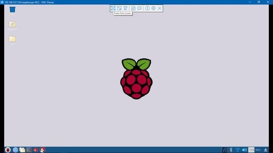

Now next time you reboot your Pi, vncserver will start automatically and will seamlessly connect your Raspberry Pi to a laptop display. Good job! Whenever you want to do something with your Pi, just connect it with an Ethernet cable to your laptop and power it. Then open the VNC Viewer, mention the IP address of your Pi, and you can use your laptop’s display as the Raspberry Pi’s monitor.
