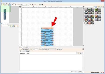

Step 3: Start Visuino, and Select the Arduino MEGA Board Type
The Visuino: https://www.visuino.eu also needs to be installed. Download Free version or register for a Free Trial.

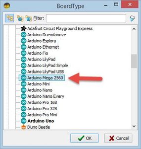

Start Visuino as shown in the first picture Click on the "Tools" button on the Arduino component (Picture 1) in Visuino When the dialog appears, select "Arduino Mega 2560" as shown on Picture 2

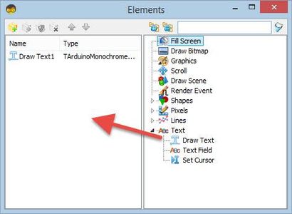

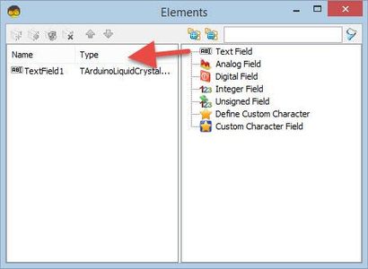

  • Double click on the "LiquidCrystalDisplay1" and in the Elements window drag "Text Field" to the left side and in the properties window set "Initial Value" to I2C-1
  • Double click on the "DisplayOLED1" and in the Elements window drag "Draw Text" to the left side and in the properties window set "Size" to 3 and "Text" to I2C-2
  • Double click on the "DisplayOLED2" and in the Elements window drag "Draw Text" to the left side and in the properties window set "Size" to 3 and "Text" to I2C-3

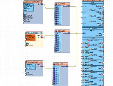

  • Connect "LiquidCrystalDisplay1" pin I2C Out to "I2CSwitch1" pin I2C 0
  • Connect "DisplayOLED1" pin I2C Out to "I2CSwitch2" pin I2C 0.
  • Connect "DisplayOLED2" pin I2C Out to "I2CSwitch3" pin I2C 0
Note: In case you are using others modules/sensors as well then just connect their I2C pins the same way.
  • Connect "I2CSwitch1" pin I2C Control to Arduino pun I2C In
  • Connect "I2CSwitch2" pin I2C Control to Arduino pun I2C In
  • Connect "I2CSwitch3" pin I2C Control to Arduino pun I2C In
