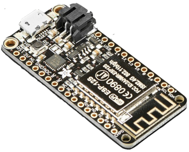

The Adafruit Feather HUZZAH ESP8266 is an 'all-in-one' ESP8266 WiFi development board with built in USB and battery charging.
The Feather HUZZAH has an ESP8266 WiFi microcontroller clocked at 80 MHz and 3.3V logic, able to be programmed using the Arduino IDE for an easy-to-use Internet of Things applications; click here for additional specs for the Feather HUZZAH ESP8266.

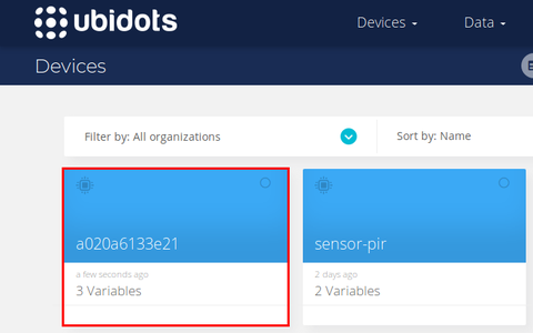

5. Confirm your data in Ubidots. Now you should see the published data in your Ubidots account.

- Device Label of the device which contains the variable to want to GET.
- Variable Label of the variable you want to GET
NOTE: The device and variable label should be defined in the following line of code:
ubidots.get("a020a6133e21", "variable_name_one")
Where the first argument defines the device's label, and the second argument the variable's label.
