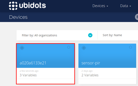

5. Confirm your data in Ubidots. Now you should see the posted data in your Ubidots account.

- Device Label of the device which contains the variable to want to GET.
- Variable Label of the variable you want to GET
NOTE: The device and variable label should be defined in the following line of code:
ubidots.get("a020a6133e21", "variable_name_one")
Where the first argument defines the device's label, and the second argument the variable's label.
